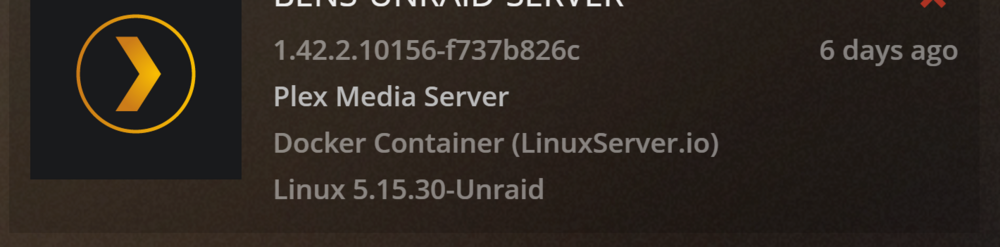

For my Plex docker, I was on:
Linuxserver.io version: 1.42.2.10156-f737b826c-ls287
Build-date: 2025-12-13T16:35:02+00:00
Gemini had suggested I change it so that I am forcing it to install / use:
lscr.io/linuxserver/plex:1.41.3.9314-a0bfb8370-ls253
However I have now set it back to download the latest version but this has not resolved the problem and am still getting the same error loop.

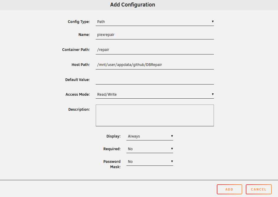

next we need to edit the docker.
and add your folder with the needed script:

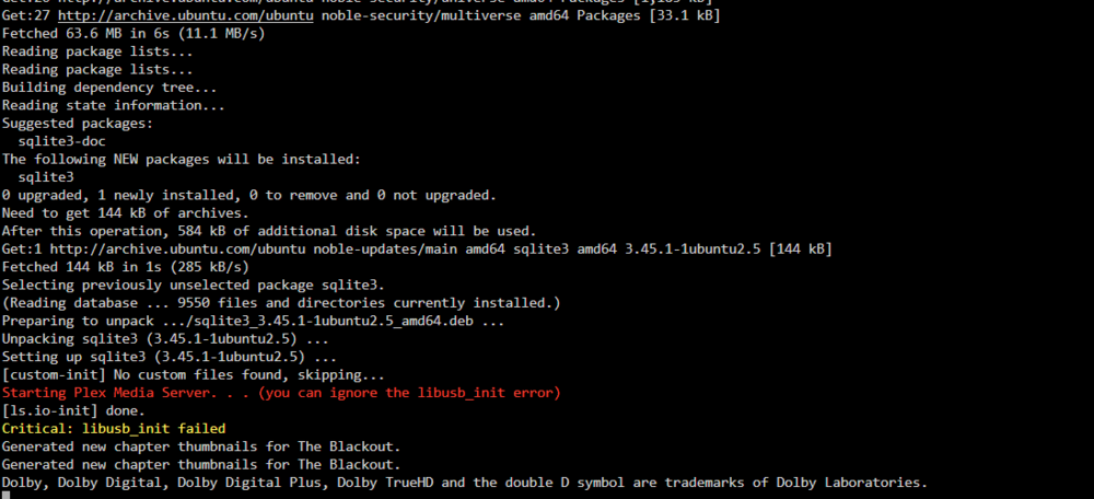

you will need to add this line to your plex extra parameters:
-e DOCKER_MODS=linuxserver/mods:universal-package-install -e INSTALL_PACKAGES=sqlite3
This will install the needed sqlite package to edit and use the plex documentation and script to fix load and mess with the plex database.
this will install the 3rd party application inside the docker see docker logs:
with the extra parm and the above script...
apply and start the docker.
next console into plex:
Move into the container folder per my picture I used /repair.
and run the db repair script.
cd /repair
./DBRepair.sh
And follow the prompts, this will keep the docker running but kill the plex application and run the necessary sqlite database commands to run clean and fix the plex database.

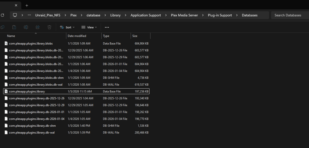

If the goal was to keep database data and I have multiple different copies of the database data, why don't we use those to "dump the sqlite file & recreate the existing database"? Like we can just swap the one of the old database files back in and try your fixes from there.
I am in a kind of working state yes but it's basically a new server. Ideally I want to restore / fix the old server and have it back as it was a couple weeks ago.

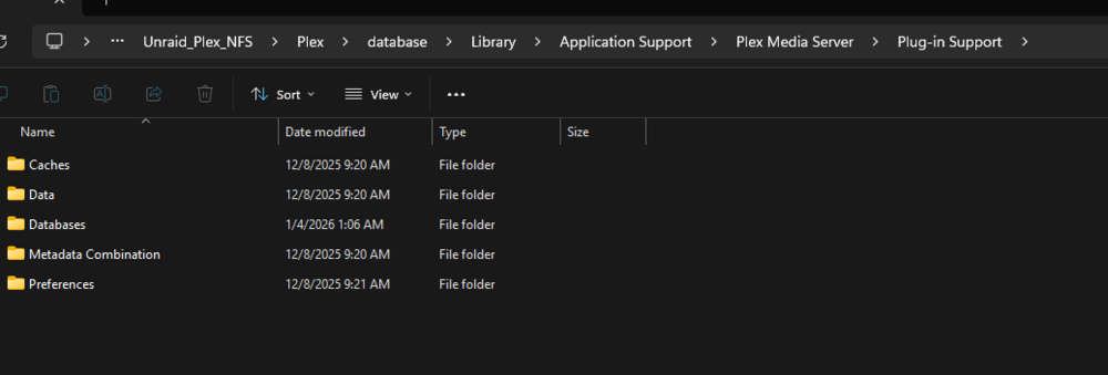

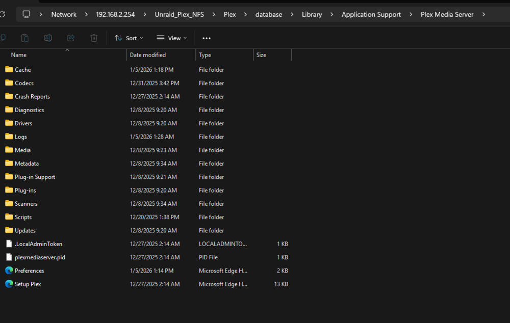

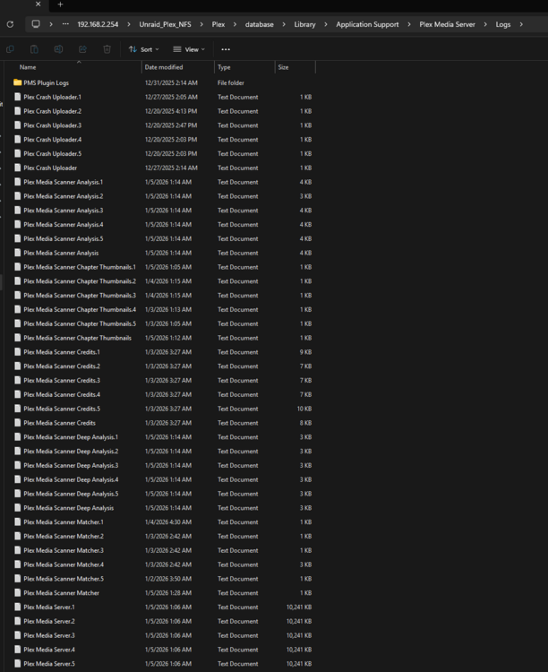

Regardless, you should have a appdata folder mapping /config
root@BMM-Tower:/mnt/vm-zfs/Dockers/Plex/database# ls
Library/
For me that here...
in this plex folder is the docker configuration and plex configuration for a plex library
and we would need to interact with files in this directory
Library/
root@BMM-Tower:/mnt/vm-zfs/Dockers/Plex/database# cd Library/
root@BMM-Tower:/mnt/vm-zfs/Dockers/Plex/database/Library# ls
Application\ Support/
root@BMM-Tower:/mnt/vm-zfs/Dockers/Plex/database/Library# cd Application\ Support/
root@BMM-Tower:/mnt/vm-zfs/Dockers/Plex/database/Library/Application Support# ls
Plex\ Media\ Server/
root@BMM-Tower:/mnt/vm-zfs/Dockers/Plex/database/Library/Application Support# cd Plex\ Media\ Server/
root@BMM-Tower:/mnt/vm-zfs/Dockers/Plex/database/Library/Application Support/Plex Media Server# ls
Cache/ Crash\ Reports/ Drivers/ Media/ Plug-in\ Support/ Preferences.xml Scripts/ Updates/
Codecs/ Diagnostics/ Logs/ Metadata/ Plug-ins/ Scanners/ Setup\ Plex.html plexmediaserver.pid
on unraid we can enable samba to use a client pc to interact with files...
IN my case this is unraid web terminal...
that said we want to interact with a few files here in same way...
first is the preferences file this is your pelx xml configurations. and we may need to remove some things from it for recreation and a plex calim latter. or fix the intinal issues...

so now that we Know or volume mounts and we know the preferences xml location (appdata) we need to find and interact with the sqlite document...
I've already posted the support articles READ THEM!!! ask question on the PLEX SUPPORT FORUM or contact plex support direct!

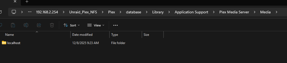

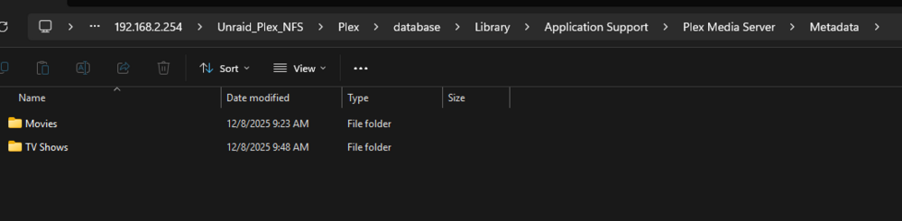

out side of the database data ther is picture metada files..
this is noted int eh metadata folder
in side these folders are a break-down into 0-### folders and inside them are Strings of pictures ... this is the content referenced in your sql lite database data and what loads the pictures for your plex library content.
This would need to be restores in the new plex docker...
Similar with media.. This contains the written data that this is xyz content with xyz date and has xyz metadata with descriptions..
all referenced and are requred to be present in the new plex meda data as you should be looking at migration support article at this point and restoring a plex library ...
Now the main piece to look into sqlite access sql dumping and sql reestore...
in plugin support in databases, you should see a sqlit database file
"com.plexapp.plugins.library"
Here is the file the db repair tool touched fixed and attempted to make repairs.
Per your comments and previous communication, you let someone else take your files and run the tool for you instead of running the tool your self...
SO NOW You're IN A WEIRD STATE AND I CAN'T HELP YOU!
TO much unknown...
BUT YOUR GOAL IS IF YOU HAVE THE FILES! Especial a file copy backup!!! as PLEX WILL DELETE MISS-MATH CED OR NON-EXISTING DATA!!!
is to get theses files together and dump your sql database... then we can use tools, commands and other application to edit and open a sql file to reload your data.
all are advance things to do but are simple go to xyz and launch xyz
BUT AGAIN You not answering question, and your is a stable state where its not worth thing to move as you can get into worse database corruption and loss due to REUSING THE plex claim key ... AND have ALREADY OVERWRITTEN PLEX SIDE DATA!
You now stuck with what you have.
I would have preferred to seen your crash log, but you chose redit and multi post and acted instated of question and doing things your self nor GOING TO THE ACTUAL SUPPORT PEOPLE!!! (I'M NOT ONE OF THEM!)
Your PLEX MEDIA SERVER CRASHED, CRASH REPORT WRITTEN: /config/Library/Application Support/Plex Media Server/Crash Reports/1.41.3.9314-a0bfb8370/PLEX MEDIA SERVER/c4f7a840-63b5-49e9-b21d76b4-561dec6a.dmp Starting Plex Media Server. . . (you can ignore the libusb_init error)
as there was problay something simple to remove, update or fix in the crash log:
BUT all of that is now gone I can't confirm no place you back into that state nor should you atampt less you face full database corruption and loss!!!

I mentioned in the OP that I am NOT running the official Plex container. I have been using the linuxserver.io container as I have done for the best part of 10 years or so since originally setting up the Plex server on Windows and then migrating to Unraid, following SpaceInvaderOne's YouTube videos. Before involving Gemini, I was on version: 1.42.2.10156-f737b826c-ls287 Build-date: 2025-12-13T16:35:02+00:00 though Gemini had suggested I forced used a slightly older, more stable version instead.
Yes I know how to access the Plex appdata folders via samba / Windows Explorer. You ask if I have OG preferences.xml file... Yes I should do. I've got an entire copy of the appdata folder through CA Appdata Restore, plus I've also got other copies of the Plex appdata folder itself as well as a copy of the the entire folder from 10am on Dec 30th. I feel like reading through the Gemini log would explain and answer all these questions about everything I did before posting asking for help. One thing of note, re-reading through the Gemini log myself now it does look like at some point I was able to successfully run the DBRepair tool from this message I sent to it:
DBRepairTool now appears to be completed...
Automatic Check,Repair,Index started.
Checking the PMS databases
Check complete.  PMS main database is OK.
Check complete.  PMS blobs database is OK.
Exporting current databases using timestamp: 2025-12-30_06.36.00
Exporting Main DB
Exporting Blobs DB
Successfully exported the main and blobs databases.
Start importing into new databases.
Importing Main DB.
Importing Blobs DB.
Successfully imported databases.
Verifying databases integrity after importing.
Verification complete.  PMS main database is OK.
Verification complete.  PMS blobs database is OK.
Saving current databases with '-BACKUP-2025-12-30_06.36.00'
Making repaired databases active
Repair complete. Please check your library settings and contents for completeness.
Recommend:  Scan Files and Refresh all metadata for each library section.
Backing up of databases
Backup current databases with '-BACKUP-2025-12-30_06.45.34' timestamp.
Reindexing main database
Reindexing main database successful.
Reindexing blobs database
Reindexing blobs database successful.
Reindex complete.
Automatic Check, Repair/optimize, & Index successful.
