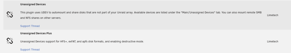

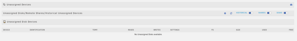

Unassigned disk plugin: https://forums.unraid.net/topic/92462-unassigned-devices-managing-disk-drives-and-remote-shares-outside-of-the-unraid-array/
Udev rule (if its the same device each time) if not use UD to manually mount

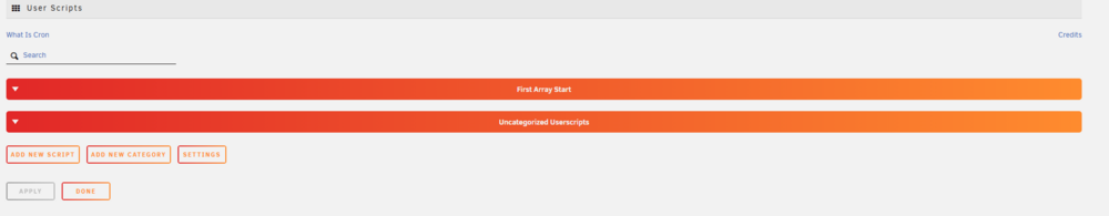

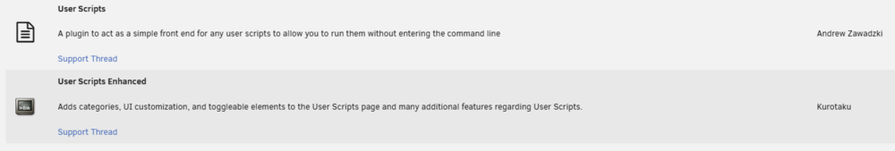

user script plugin and rsync command line to mount the disk, copy folder to the drive.
https://forums.unraid.net/topic/48286-plugin-ca-user-scripts/
where you can set cron is the removable device stays the same...
3 0 * * 0
https://crontab.guru/#3_0_*_*_0
see example script:
https://forums.unraid.net/topic/97958-rsync-incremental-backup/

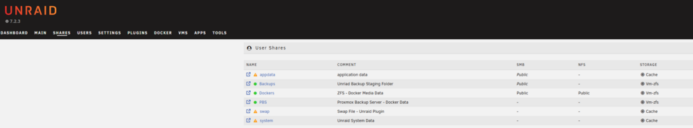

what i do is make a share / staging folder for backups.
then with other plugins / scripts
such as appdata backup plugin.
appdata backup will make a tar backup of the docker systems and vms xml and if you chose so, makes a unraid flash drive backup...

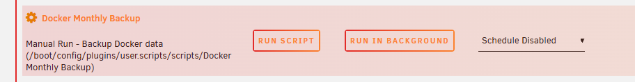

So I mount a usb make edits if needed and hit run script manual (it can be scheduled...)
this is something fairly easy to setup for weekly backup. even remote connection to other systems no usb / disk pluged in. still requires mounting the remote systems or connecting in some way...
