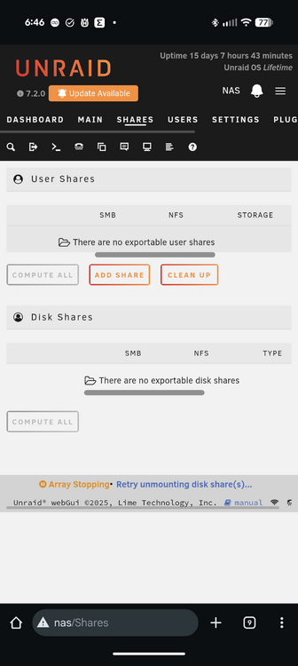

Hey folks, new Unraid user here. I've attached three diagnostics files:
  • One upon discovering shares were missing.
  • The second after trying to stop the array (which hung).
  • The third after running powerdown -r, which also hung.
The system I built myself. I've run memtest as well as stress-ng when booted to a live USB, neither uncovered anything interesting. I'm open to suggestions on other ways to rule out hardware issues.
Running Unraid 7.2.0, I believe I saw the issue on the previous version I was running as well, but I don't remember what that version was.
Every so often (between a few days to in this case about two weeks of uptime) the shares will all disappear. Screenshot attached. At this point my frigate container crashes (because it's trying to write video to disk). dmesg shows an oops, general protection fault, stack trace, etc. I believe something similar is also printed to the console, but I don't have my monitor hooked up right now.
At this point I try to stop the array, which hangs forever (UI says "Array Stopping•Retry unmounting disk share(s)" at the bottom). Shutdown from the UI or via powerdown -r also hangs indefinitely. As far as I can tell the only way to reboot the system in this state is to hold the power button.

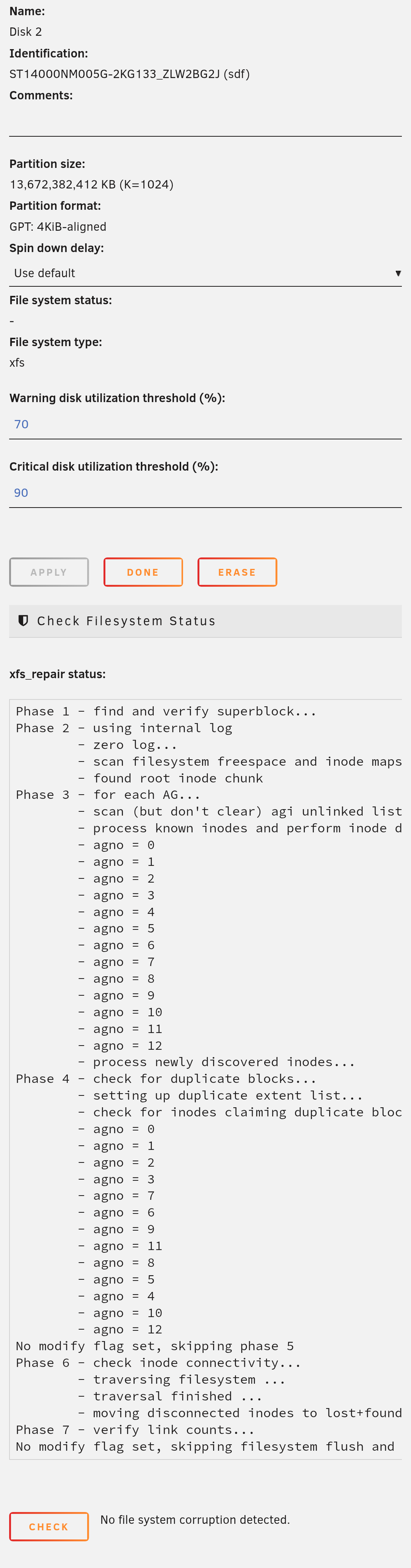

Jan 6 02:00:12 NAS kernel: XFS (md2p1): Metadata corruption detected at xfs_dinode_verify+0xa4/0x6f0, inode 0xa45bcc36 dinode
Jan 6 02:00:12 NAS kernel: XFS (md2p1): Unmount and run xfs_repair
Check filesystem on disk2
Followed the instructions for disk2 (and disk1 and disk3 as well for good measure). The check ends with "No file system corruption detected" (screenshot attached).
For what it's worth, I don't remember seeing that message in the logs when my issue has occurred in the past.
It does seem strange to see that message and not have anything show up in the check, or somewhere in the UI for that matter.
