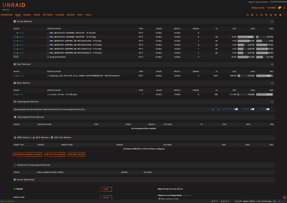

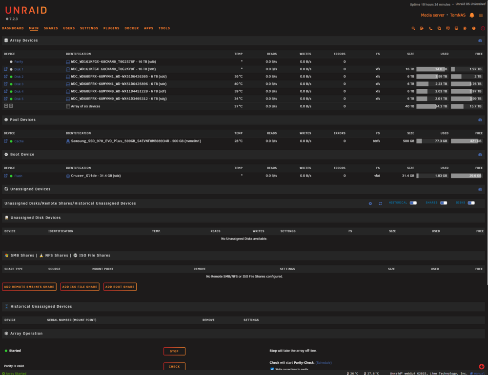

quick heads up: no errors after 10.5hrs

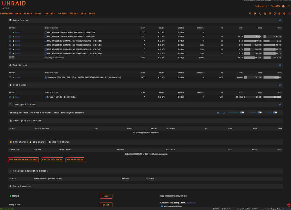

Disk3 had some errors during mount, so not spin up related, the other 3 were again the right spin up.
It's quite strange; those disks are quite common, and I've never seen a similar issue with those and spin up, also all the errors are logged as a disk problem, so there could be an issue with the disks, like a power or firmware issue, I would be surprised if all 4 are actually failing, but it's not impossible.

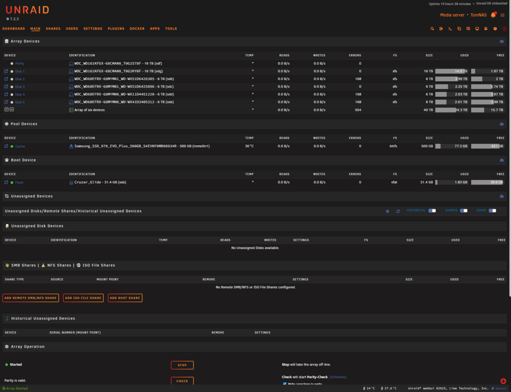

Errors were again after spin up, so I guess those drives don't like that, but before one of them also had errors without spin-up, so there may be something else going on
ok. I guess I'll have to replace the 4x 6TB HDDs with 16TB WD Red Pro. Maybe they have reached their max lifetime... Thanks for your Support JorgeB!
