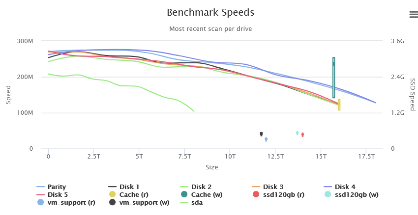

Assuming all drives are functioning correctly, the 40 hour parity rebuild is due to the small capacity drives. A spinning hard drive's access time is at it's fasted when accessing its first sector, and its slowest accessing the last. The difference is approximately 50% slower. The parity rebuild can only run as fast as the slowest drive in the array, at the sector which is being read at at hat time.
So let's use an example that is a bit simpler than your server - 3 drives, a 8TB, 4TB and 2TB. I'll assume that all have identical access times (which in real life, won't be true, as the smaller drives typically are older technology and are slower at both first and last sector). Let's say 200MB/s to start, 100MB/s at last sector.
  • At starting the parity check, speeds are at 200MB/s.
  • At 1TB done, the 2TB drive is at 150MB/s. Just before 2TB, at 100MB/s. (An 8TB drive would be capable of 175 and 150MB/s respectively)
  • Once past 2TB, the speed will jump back up to 150MB/s, as the 2TB drive is now idle. It will work its way back down to 100MB/s at the 4TB mark.
  • Now just 8TB drives are being red, so speeds again jump to 150MB/s, ramping down to 100MB/s until the parity is completed.
As your server now is just a Proof Of Concept test, these old drives are fine to do your testing with. Ideally, a smaller number of larger capacity drives are a better choice, as you benefit from faster access speeds, lower power consumption and less things to go wrong or fail.
My main server has 18TB and 16TB drives. My parity checks, run quarterly, average 185MB/s and run for just under 27 hours. The image is a screenshot from the DiskSpeed docker, available on Community Applications. It is a great benchmark/diagnostic tool to see the performance of your drives.
