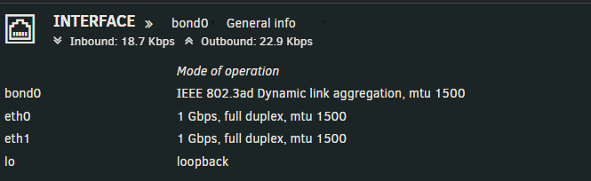

I run Unraid 7.2.0 on a Dell T440 server with two Gigabit Ethernet ports. They are bonded as bond0 using 802.1ad LAG. The two ports connect to a Cisco SG200-26 26-Port Gigabit Smart Switch, on ports GE25 and GE26. They are also configured as LAG. When I first built the system, I did an informal test copying large files from network hosts to the array. On the Dashboard Interface, I saw the Inbound go well above 1000 Mbps, so I thought Bonding was OK.

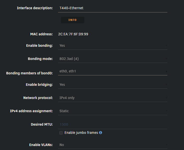

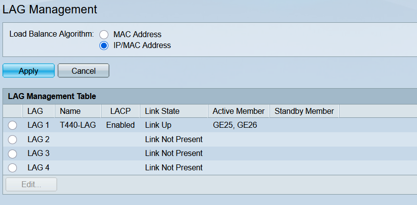

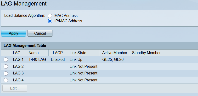

Now I've run a more precise test with iperf. Running a single iperf test with the client on a system on the LAN to the Unraid Server running iperf server shows throughput of 950 Mbps. I expected running simultaneous iperf (from separate hosts on the LAN to two different iperf server ports on Unraid) would show a speed around 1900 Mbps due to LAG. What actually happens is each iperf test slows down to about 300 Mbps when run concurrently.
Gemini suggested changing Unraid xmit_hash policy. It is currently layer2:
root@T440:~# cat /sys/class/net/bond0/bonding/xmit_hash_policy
layer2 0
The recommendation is
ifconfig bond0 down
echo layer3+4 > /sys/class/net/bond0/bonding/xmit_hash_policy
ifconfig bond0 up
I have not done that because the only way I access Unraid is by the network, so I'd have to add a monitor and keyboard to retain connectivity.
Is this the first thing to look at for poor network performance with Bonding and Lag?
