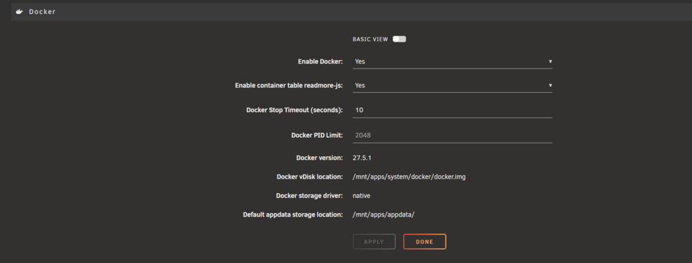

I went ahead and recreated it, moved it to the Apps drive pool, thought I'd done that when I set it up but I guess not. Got all the necessities back up and running and I think got everything important configured more correctly, here's what I changed. If I have anything else that's a ticking time bomb I'd like to change it too, but thank you for the help on ID'ing the problem.

Actually, you have system share configured to be on nvme, not apps. And you already moved docker.img to apps instead of to nvme where the other system files belong.

docker.img is in system share too, but you also moved it to apps
