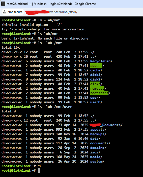

What do you get from command line with this?
ls -lah /mnt
and this?
ls -lah /mnt/user

The output from those two commands is the following:
To me this seems to all be normal. Again I didn't update anything prior to this occurring. It's only since this problem started that I've made changes. Overall I'm wondering if this isn't more a problem with the individual docker containers that are problematic rather then an UNRAID related issue.
