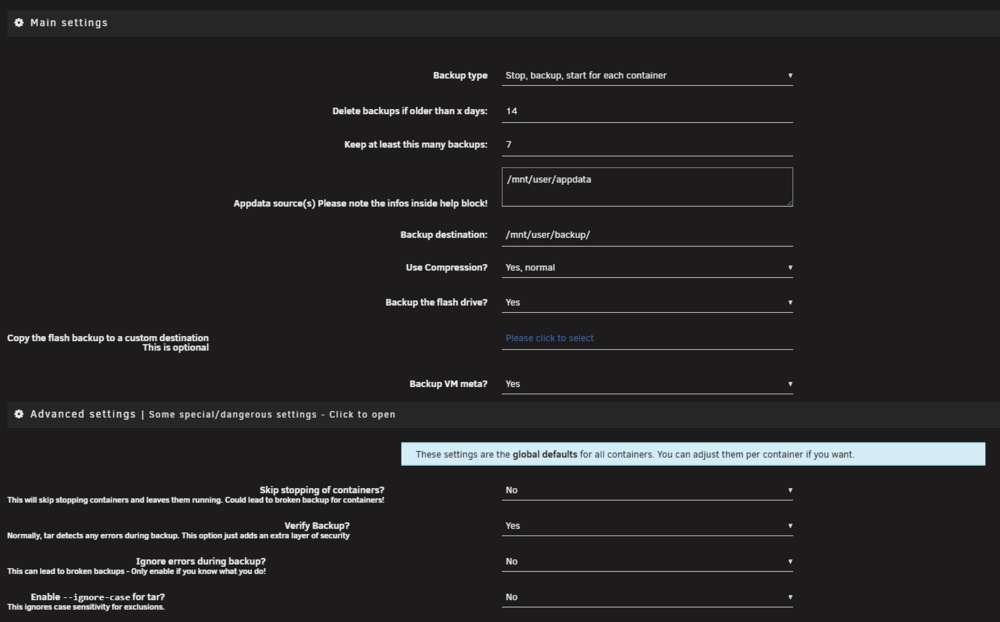

Also, I saw someone mention their appdata backup plugin was causing their issues. Do these settings look correct?
I ended up backing up the config inside each container, turned off Docker, renamed appdata to appdata-old, turned Docker back on and restored the backup within each container. That seemed to work fine.
