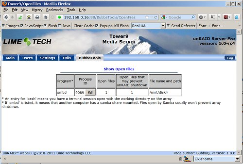

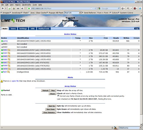

BubbaTools has a component that adds an alert to the GUI if any files are open, and will show them to you, and let you kill the process that has each one open.
