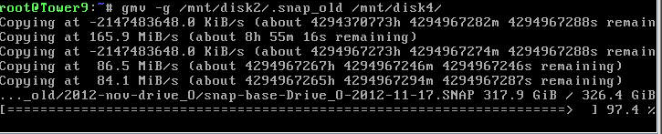

By "haste" I meant abandoning the project permanently. I completed my tests and all the hashes all match, so even on files over a TB, there was no corruption.

Don't be hasty.... I'm running hashes against them now to compare to backups. You might just need to use long integers and recompile it.
