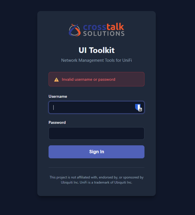

Ill try to install the unifi-toolkit on my unraid. I am using cloudflare tunnel to access the webinterface. How can i configure the login? The way in the manual isnt working for me. Password or username is wrong.
If you use Local type :
>>> Local - For LAN-only access (no authentication, no HTTPS)
you better put a reverse proxy in front of it and kill the exported port
I am not using local. Thats why i am asking. How to configure the login credentials. The info in the manual doesnt work for me. Its always wrong credentials.image.png

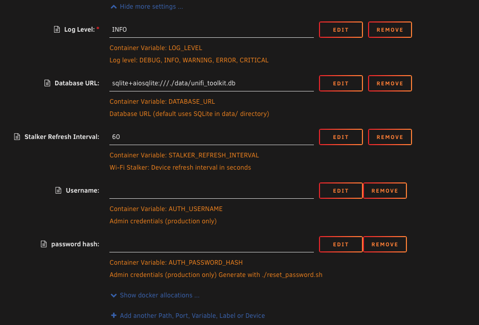

Alright,
go to advance mode in unraid
then click on Show more settings ...
then yu will be able to see username and password for production
Dont forget the password is a HASH not the actual password
let me know
There is only the username.. The password hash is empty.
you have to provide
How can i get the hash? If i use the setup.sh its not showing the hash.
Also with reset_password.sh there is no hash... Should i pick the hash from the .env file? Where do i find this file?

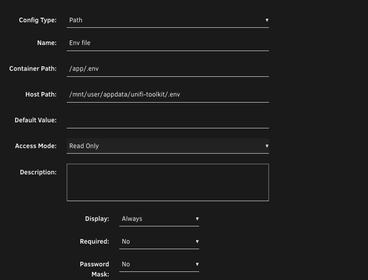

Here what i would do , but seems to be tested , i will try test this later today .
run setup.sh
move .env to /app/data
add a path in the template :
let me know if that worked
again i did not test this use case yet . i only test local type
Edited by ZappyZap
Sadly not, that doesnt work as well...
