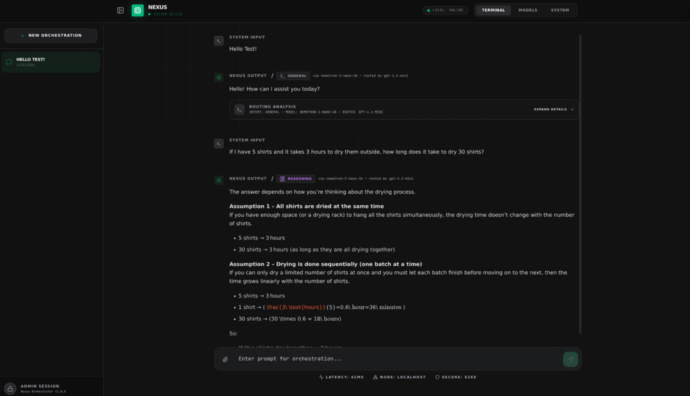

At its core, a lightweight router model classifies each promptโ€™s intent (CODING, REASONING, CREATIVE, VISION, DOCUMENT, or GENERAL) and dispatches it to whichever model youโ€™ve configured for that category. You can freely mix local Ollama models with cloud providers in any combination.

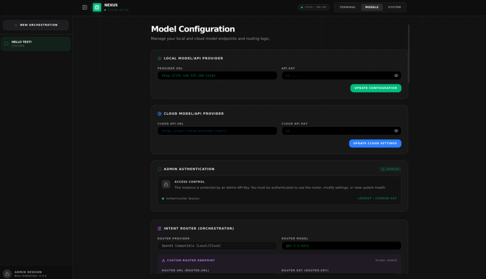

Configuration Guide
This guide covers the basic configuration needed to get Nexus Router working with local and optional cloud models.
LOCAL MODEL / API PROVIDER
This should point to your local LLM backend, usually Ollama.
Set the Provider URL to your machineโ€™s IP address
Example: http://192.168.1.100:11434
Do not use localhost, as that refers to the container itself
Leave the API Key blank for standard Ollama setups
Nexus will automatically detect Ollama and handle the connection
CLOUD MODEL / API PROVIDER (Optional)
This is for OpenAI-compatible providers such as OpenAI or OpenRouter.
Enter your API key
If left unconfigured, any categories set to Cloud will show a warning
Local-only setups will still function normally
INTENT ROUTER
The router determines which category handles each request.
A small model is sufficient
Recommended: gemma3:4b, qwen2.5:3b
Leave the Router URL blank to reuse your local provider
Only set a custom URL if you want a separate routing endpoint
DISCOVERED MODELS
Nexus will list all models available from the Local Provider.
If models do not appear:
Verify the Provider URL is correct
Ensure the status shows Online
Models can be selected and assigned to categories from this list

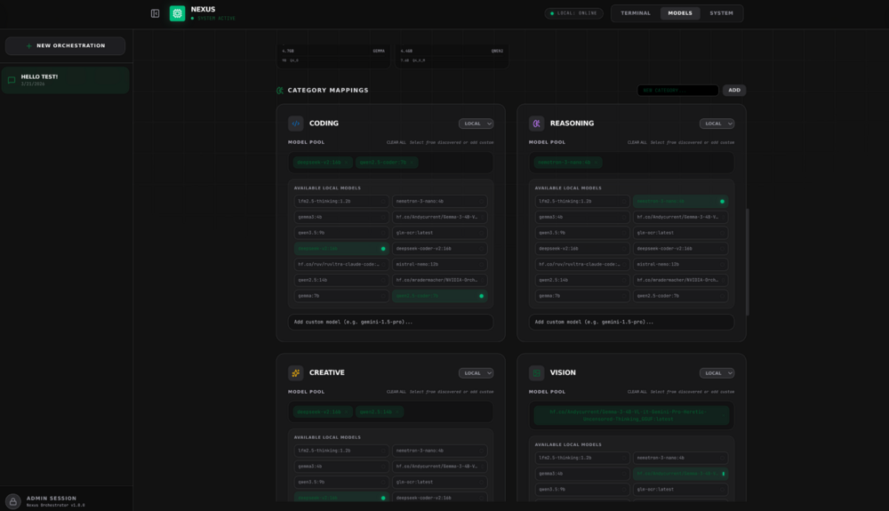

CATEGORY MAPPINGS
Categories define how requests are routed.
Each category includes:
A provider (Local or Cloud)
A pool of models
A fallback order (first model is primary, others are used if it fails)
Default categories:
GENERAL โ€” general conversation
CODING โ€” programming and debugging
REASONING โ€” math, logic, and analysis
CREATIVE โ€” writing and brainstorming
VISION โ€” triggered by image input
DOCUMENT โ€” triggered by file input
FAST โ€” simple, low-latency responses
SECURITY โ€” security research and testing
Custom categories can be added from the Models tab
