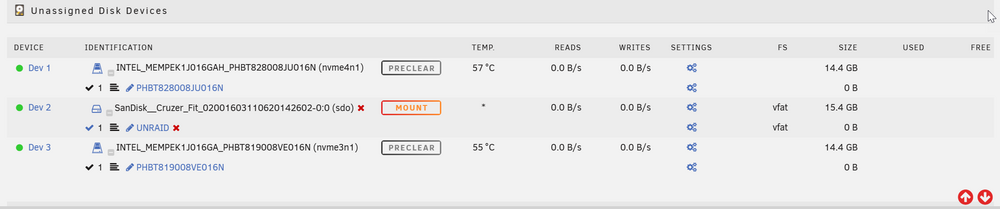

I've booted from the flash and the drives are as below.
I have the two new drives.

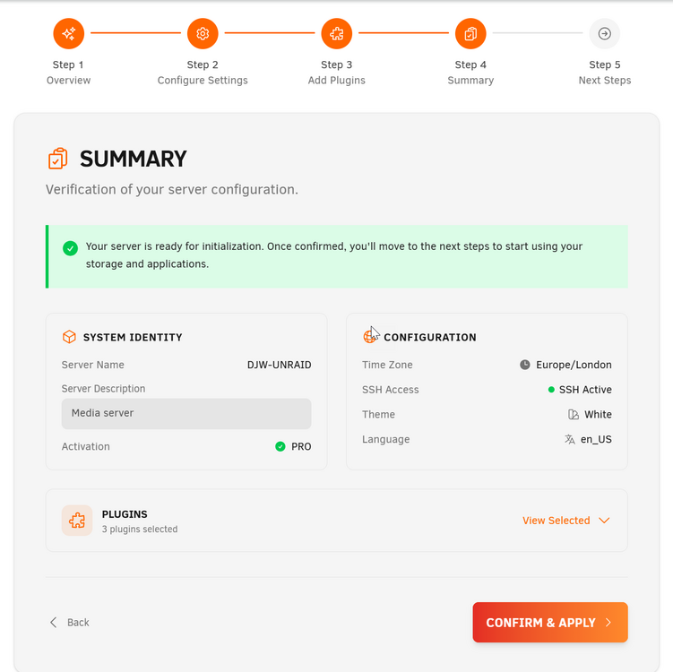

But when I run through the onboarding process it just shows my existing setup and ask me to confirm and apply but doesn't give me an option to create a new pool.
What am I doing wrong? I'm also getting a license mismatch after booting with flash. I assume this is correct because I'm assuming it's due to swapping boot devices?

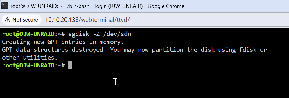

You need to wipe them before, you can use sgdisk -Z /dev/sdx (all data will be lost)

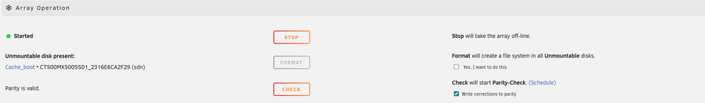

I've run the command on the boot disk. Which is now showing as unmountable. Do I need to do anything after this, as it's still not allowing reconfiguration in the onboarding process. Am I being stupid?
Array must be stopped for onboarding wizard; also, the boot disk cannot be assigned to any pools.
Sorry. The screenshot is a little misleading. I started the array after trying the onboarding wizard, as I need to retrieve some files.
The array was stopped when I tried.
And the device is unassigned? I assume the onboard loads you just don't see the boot pool option?
Correct. The original boot device is unassigned, as are the 2 Optane drives. The onboard loads, it shows the configuration page for server name, etc, then the plugins and finally the summary with confirm and apply, but no boot options.
