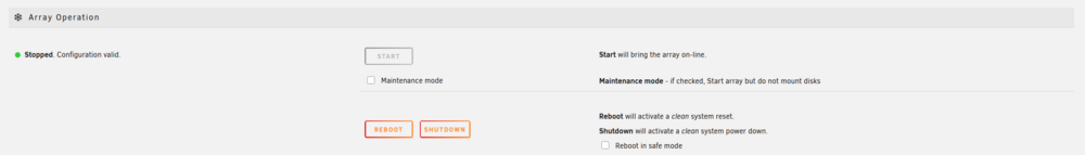

The array reports "Stopped. Configuration valid." but when I click on Start, the button goes gray but the array doesn't... start. No dancing unraid logo, etc.
For context it appears like this, but the array doesn't start.
