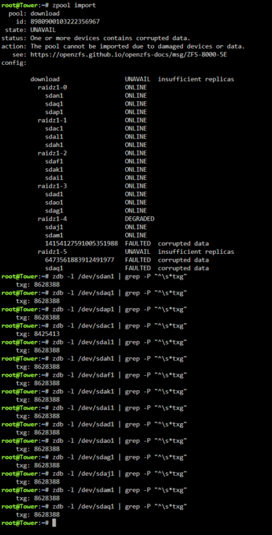

Im not sure what's going on here. Not sure why it has 6 groups now and i only have 15 drives and why 1-5 only has 2 drives. Im thinking the 1-5 drive is supposed to be in 1-4. Not sure if its possible to retrieve the data at this point. I was using this setup for testing and forgot it was setup like this. Any help would be appreciated. Thanks in advance.
I assume the pool was not created using the GUI? The last vdev is raidz1 with two faulted devices, so it won't likely be possible to recover, post the output of zdb -l /dev/sdX1 | grep -P "^\s*txg" for all pool members and also the diagnostics.
It was made with the GUI. The last vdev shouldn't be possible though, correct? It only has 2 drives and you can't mix and match vdev setups? I should have 5 groups of 3 drives, i had 5 groups of 3 at one point. I only have 15 drives and those weird long numbers are not drives. Talk to me like im an idiot lol im still learning. I'm an idiot but somehow the last vdev took a drive from 1-4 idk?
Maybe im doing something wrong but nothing happens with zdb -l /dev/sdX1 | grep -P "^\s*txg"

Not using the GUI, hence my question: it should never accept a smaller vdev.
You need to replace X with the correct identifier for each pool member, e.g., /edv/sdan1
This was a test zfs setup when they first added it natively to unraid. It was definitely made using the gui. Not sure it is possible but is there any way to add sdaq1 back into 1-4 and get rid of 1-5. Thank you for being patient with me. This all happened after i had a power outage and i didn't realize my ups batteries were screwed so it did not shut down clean. i was also transferring a large amount of files around.

Type zpool import -F download; it will likely still fail to import, but then grab and post the output from tail -n 100 /proc/spl/kstat/zfs/dbgmsg
Also post the diagnostics.

root@Tower:~# zpool import
pool: download
state: UNAVAIL
status: One or more devices contains corrupted data.
action: The pool cannot be imported due to damaged devices or data.
see: https://openzfs.github.io/openzfs-docs/msg/ZFS-8000-5E
config:
download UNAVAIL insufficient replicas
raidz1-0 ONLINE
sdan1 ONLINE
sdaq1 ONLINE
sdap1 ONLINE
raidz1-1 ONLINE
sdac1 ONLINE
sdal1 ONLINE
sdah1 ONLINE
raidz1-2 ONLINE
sdaf1 ONLINE
sdak1 ONLINE
sdai1 ONLINE
raidz1-3 ONLINE
sdad1 ONLINE
sdao1 ONLINE
sdag1 ONLINE
raidz1-4 DEGRADED
sdaj1 ONLINE
sdam1 ONLINE
14154127591005351988 FAULTED corrupted data
raidz1-5 UNAVAIL insufficient replicas
6473561883912491977 FAULTED corrupted data
sdaq1 FAULTED corrupted data
Edited by Abuseddoughboy

type: 'disk'
guid: 4236473859647311292
path: '/dev/sdam1'
whole_disk: 0
DTL: 1323
create_txg: 4
features_for_read:
com.delphix:hole_birth
com.delphix:embedded_data
com.klarasystems:vdev_zaps_v2
labels = 0 1 2 3
root@Tower:~# zdb -l sdao1
LABEL 0
version: 5000
state: 0
txg: 8628388
pool_guid: 8980900103222356967
errata: 0
hostname: 'Tower'
top_guid: 7301492552058973520
guid: 4842366315372101292
vdev_children: 6
vdev_tree:
type: 'raidz'
nparity: 1
metaslab_array: 155
metaslab_shift: 34
ashift: 12
asize: 9001764126720
is_log: 0
create_txg: 4
children[0]:
type: 'disk'
guid: 5133868157694348226
path: '/dev/sdap1'
whole_disk: 0
DTL: 1325
create_txg: 4
children[1]:
type: 'disk'
path: '/dev/sdaf1'
whole_disk: 0
DTL: 1324
create_txg: 4
children[2]:
type: 'disk'
path: '/dev/sdam1'
whole_disk: 0
DTL: 1323
create_txg: 4
features_for_read:
labels = 0 1 2 3
root@Tower:~# zdb -l sdag1
LABEL 0
version: 5000
state: 0
txg: 8628388
errata: 0
hostname: 'Tower'
vdev_children: 6
vdev_tree:
type: 'raidz'
nparity: 1
metaslab_array: 155
metaslab_shift: 34
ashift: 12
is_log: 0
create_txg: 4
children[0]:
type: 'disk'
path: '/dev/sdap1'
whole_disk: 0
DTL: 1325
create_txg: 4
children[1]:
type: 'disk'
path: '/dev/sdaf1'
whole_disk: 0
DTL: 1324
create_txg: 4
children[2]:
type: 'disk'
path: '/dev/sdam1'
whole_disk: 0
DTL: 1323
create_txg: 4
features_for_read:
labels = 0 1 2 3
root@Tower:~# zdb -l sdaj1
LABEL 0
version: 5000
state: 0
txg: 8628388
errata: 0
hostname: 'Tower'
top_guid: 10926724634284429583
guid: 12224681384942138511
vdev_children: 6
vdev_tree:
type: 'raidz'
nparity: 1
metaslab_array: 149
metaslab_shift: 34
ashift: 12
is_log: 0
create_txg: 4
children[0]:
type: 'disk'
path: '/dev/sdaj1'
whole_disk: 0
DTL: 1332
create_txg: 4
children[1]:
type: 'disk'
guid: 11660946513604001104
path: '/dev/sdag1'
whole_disk: 0
DTL: 1331
create_txg: 4
children[2]:
type: 'disk'
guid: 14154127591005351988
path: '/dev/sdaq1'
whole_disk: 0
not_present: 1
DTL: 1330
create_txg: 4
features_for_read:
labels = 0 1 2 3
root@Tower:~# zdb -l sdam1
LABEL 0
version: 5000
state: 0
txg: 8628388
errata: 0
hostname: 'Tower'
vdev_children: 6
vdev_tree:
type: 'raidz'
nparity: 1
metaslab_array: 149
metaslab_shift: 34
ashift: 12
is_log: 0
create_txg: 4
children[0]:
type: 'disk'
path: '/dev/sdaj1'
whole_disk: 0
DTL: 1332
create_txg: 4
children[1]:
type: 'disk'
path: '/dev/sdag1'
whole_disk: 0
DTL: 1331
create_txg: 4
children[2]:
type: 'disk'
path: '/dev/sdaq1'
whole_disk: 0
not_present: 1
DTL: 1330
create_txg: 4
features_for_read:
labels = 0 1 2 3
root@Tower:~# zdb -l sdaq1
LABEL 0
version: 5000
state: 0
txg: 8628388
errata: 0
hostname: 'Tower'
top_guid: 3639066115140394353
guid: 1984276560438213106
vdev_children: 6
vdev_tree:
type: 'raidz'
nparity: 1
metaslab_array: 170
metaslab_shift: 34
ashift: 12
is_log: 0
create_txg: 4
children[0]:
type: 'disk'
guid: 15606560977127719128
path: '/dev/sdac1'
whole_disk: 0
DTL: 1329
create_txg: 4
children[1]:
type: 'disk'
path: '/dev/sdae1'
whole_disk: 0
DTL: 1328
create_txg: 4
children[2]:
type: 'disk'
guid: 7529842671122589782
path: '/dev/sdad1'
whole_disk: 0
DTL: 1327
create_txg: 4
features_for_read:
labels = 0 1 2 3
Not sure how you ended up with a pool in this state, but you have a six-vdev pool structure where several physical disks are being claimed by multiple VDEVs simultaneously. This is why the standard import fails; ZFS cannot verify which VDEV a disk truly belongs to when the labels provide conflicting information.
  • raidz1-0 (ID 0): Claims /dev/sdan1, /dev/sdaq1, and /dev/sdap1
  • raidz1-1 (ID 1): Claims /dev/sdac1, /dev/sdal1, and /dev/sdah1
  • raidz1-2 (ID 2): Claims /dev/sdaf1, /dev/sdak1, and /dev/sdai1
  • raidz1-3 (ID 3): Claims /dev/sdad1, /dev/sdao1, and /dev/sdag1
  • raidz1-4 (ID 4): Claims /dev/sdaj1 and /dev/sdam1. It specifically lists its third child (GUID 1415...) as not_present.
  • Missing Disk: sdaq1 is the biggest point of failure. Its label says it belongs to VDEV 0, but the pool config (as seen in your first screenshot) is trying to find it in VDEV 5 (the phantom VDEV) and VDEV 4.
I doubt the opoio can be imported as is, but try this as a last resort:
Delete the ZFS state cache first just in case it's being used:
rm /etc/zfs/zpool.cache
Then try the "Extreme" recovery flag
zpool import -d /dev/disk/by-id -f -F -X download
This may take a long time (minutes to hours) as it traverses every disk to find a valid Uberblock.
If that fails, you can try a read-only import, to see if you can get the data off the pool:
zpool import -d /dev/disk/by-id -o readonly=on -f -F -X download
If none of those work, I'm afraid the data may be lost.
Nothing worked, unfortunate but oh well. THank you for the help.
