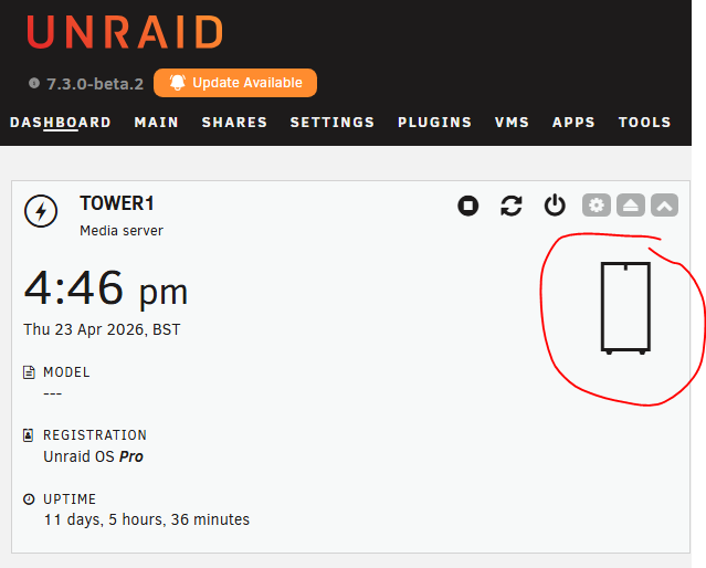

Unraid loon screen I noticed a retangular square with E902 inside of it.
Solved by JorgeB
You can attach a screenshot directly to your next reply
Here is the sreenshoot.
That suggests you are using a custom case icon, you can change it in the dashboard; click the case icon:
That solved it. Thank you,
