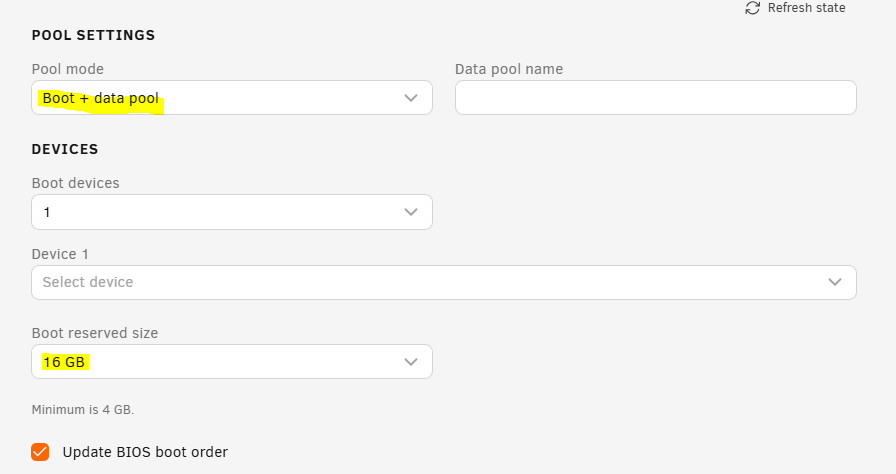

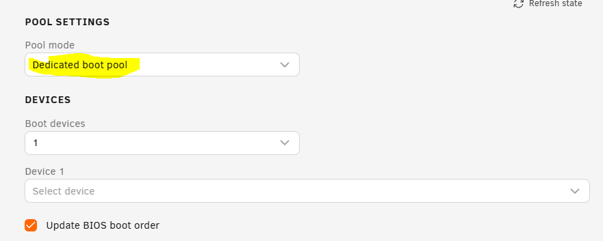

Should the wizard have the ability to define a partition size?
7 minutes ago, jaybird2203 said:
. It was this portion that didn't allow the ability to define a partition size and used the full drive.
In the wizard you can select between a dedicated or split pool, default is dedicated.
