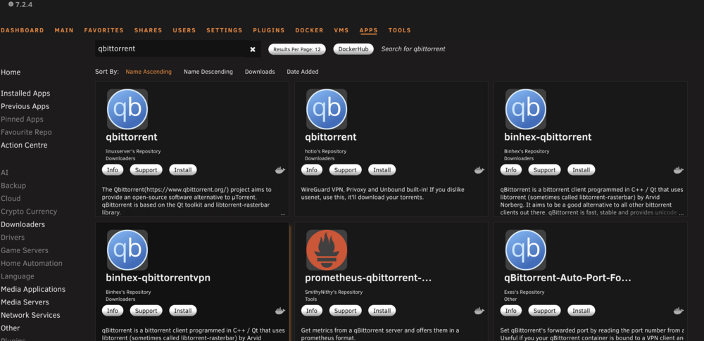

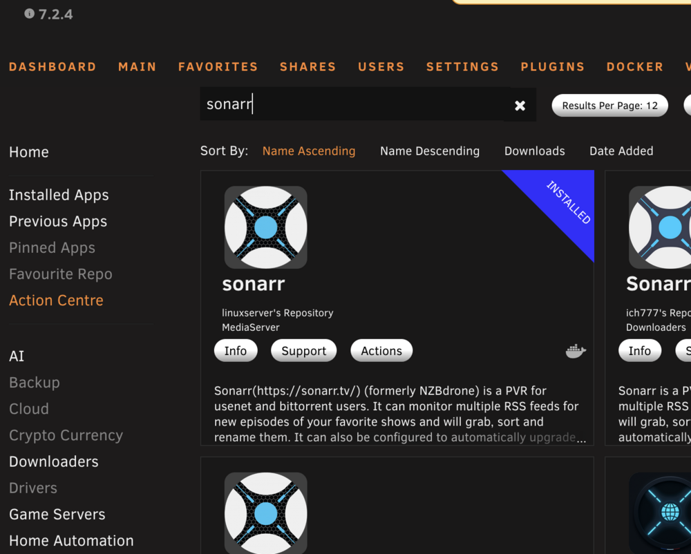

I default to using linuxserver.io containers, I just so happened to notice that in Community Apps when I search for qBittorrent, it does not have the 'installed' flag as my other containers do.
Is there a broken linkage that I can fix?

Did you rename it from the default? If so that'll "break the link".

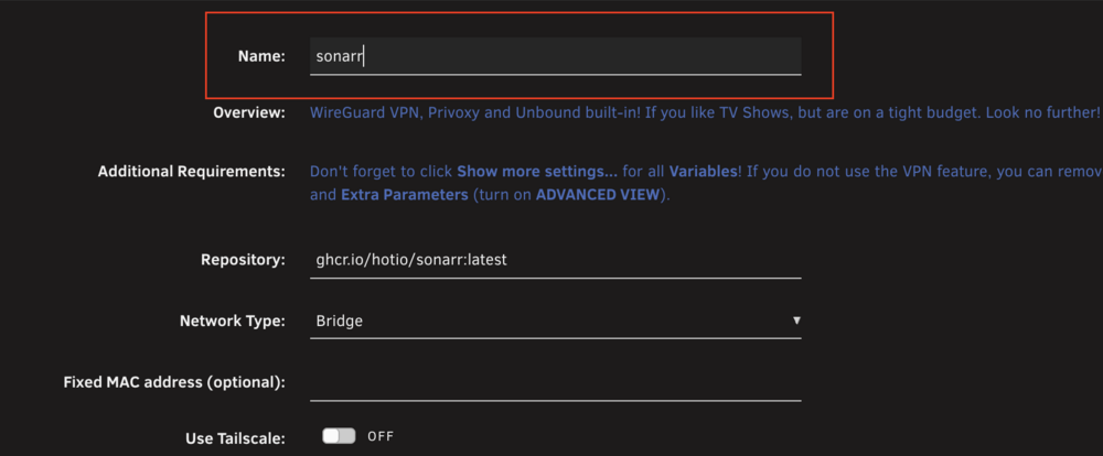

Are you referring to the name of the container? This spot:
I can't image putting in a custom name, will break a link to the repository? This broken update link is happening on custom names and on default names. I would only position that if the name is changed, the 'update' check should point and reference the repository and not search for whatever name I call it. And if changing the name breaks something, then why are we allowed to change it?
