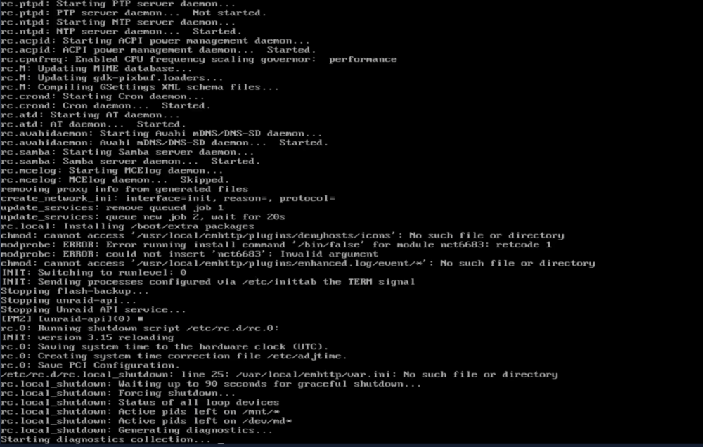

Unraid 7.2.7 not booting completely. Just generating diagnostics
Something happened on my unraid server this afternoon and I cant seem to get around it. The JetKVM stopped responding and I could not see what happened when I lost access. I also had to force shutdown as it wasnt responding to the power button. When I booted it again with the KVM active and working. I saw that it was just shutting down again and collecting diagnostics.
Is this a USB flash drive corruption/issue?
Thank you for any advice on some direction. Ive had no issues as bad as this before.
Attached are the generated diagnostics.

Will it boot in SAFE mode?
just booted into safe mode now. had a deeper look into the logs and i think it might be the nut plugin. Its showing as unhealthy so its initiating the shutdown. Il try to remove that for now, even though my nut server should be up..
Jun 27 17:03:55 VIENNA plugin-manager: nut-dw.plg installed
Jun 27 17:03:55 VIENNA upsmon[9362]: UPS [email protected]: forced shutdown in progress
Jun 27 17:03:55 VIENNA upsmon[9362]: Too few UPS(es) are healthy (0<1), initiating forced shutdown
Jun 27 17:03:55 VIENNA upsmon[9362]: Executing automatic power-fail shutdown
Jun 27 17:03:55 VIENNA upsmon[9362]: Auto logout and shutdown proceeding
