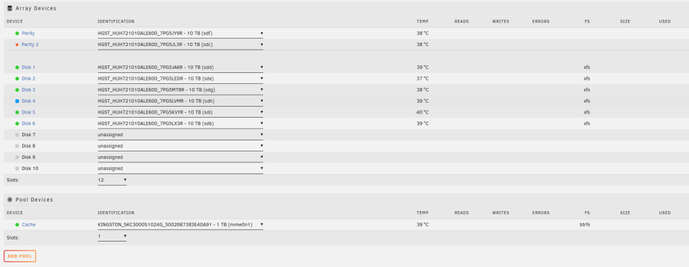

Today i went to check up on my Unraid media server and i was greeted with an array showing 1 (of 2) parity drive and 1 data drive as disabled. The server itself seems fine and all drives short SMART report came out clean so i rebooted the server, hoping it would clear up. Unfortunately, things got worse - the missing data drive came back showing as "new disk" and the parity drive continues to be disabled for no apparent reason.
Removing the data drive from the array and mounting it with UD works fine, all of its content seems to be there and accessible. But for some reason Unraid is reading it as a new replacement drive.
Furthermore, the parity drive's file system seems to have shifted and now it no longer reads the same size as the other parity drive that is still working. As a result, the array cannot be started:
Indeed looking at the logs of the server, the second parity drive (sdc) now shows FS starting at sector 2048 like a data drive, as opposed to sector 64 like Parity disk 1 (sdf).

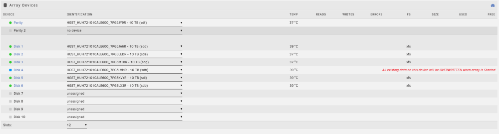

Now here's the real pickle: How do i recover this array without losing any data? Removing the parity 2 drive assignment causes a notification to pop-up that upon start of the array the missing data drive will be overriden (im guessing it's going to try to rebuild it?)
Im currently running a full SMART check on Parity drive 2 (sdc), it's taking a long while. But i dont feel like it's going to reveal anything more than the short SMART check. To me it looks like a corrupted array config rather than failed drives. Any ideas?

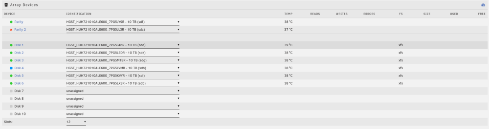

Upon further inspection, it seems drives sdc and sdh may have somehow switched places in UnRaid. Drive sdh appears to have the same FS size parameters as Parity drive sdf.
But curiosly, mounting drive sdh via UD shows it to have the expected data drive contents, while drive sdc is unmountable (as i would expect from the parity drive - my understanding is that the parity drives hold raw bit data for doing the bitwise parity math with the other drives in the array). How can one resolve this situation??

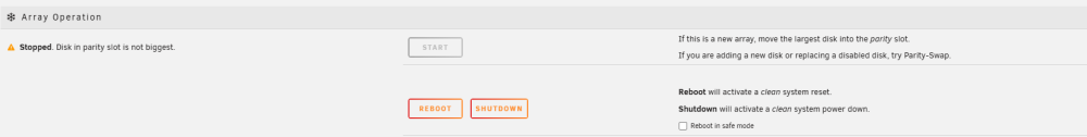

The problem is i cannot start the array in this configuration. When i re-assign the drives to their original assignements, it gives an error that Parity drive is not biggest. The content of disk 4 does otherwise look correct, yes.
Parity2 is 1 MiB aligned, instead of the default 4 KiB. Update to 7.3.2, it should be able to handle that automatically. If not, post new diags after updating since it provides better partition info on the syslog.

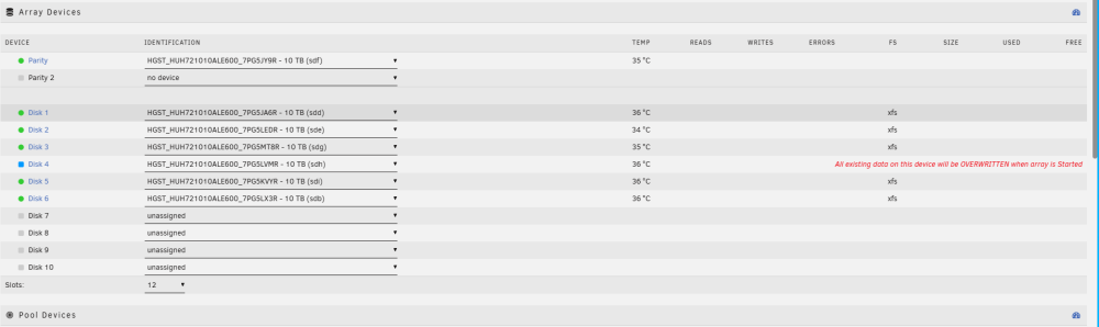

Removing Parity 2 disk allows the array to start but gives warning that all data on disk 4 will be overriden. Is that ok?
Also should i start the array in Maintenance mode? Help page you linked earlier says it speeds up the process.
Also are you sure the rebuild of disk 4 will make it 4k-alligned? All other data drives are also 1MB-alligned like Parity 2.
Edited by alexfsr
That's expected since it will be rebuilt; since the emulated disk was mounting you can proceed, you can do it in maintenance mode if you prefer, but it's fine in normal mode as well if you need to access the array; just avoid array heavy activity to not slow down the rebuild.
