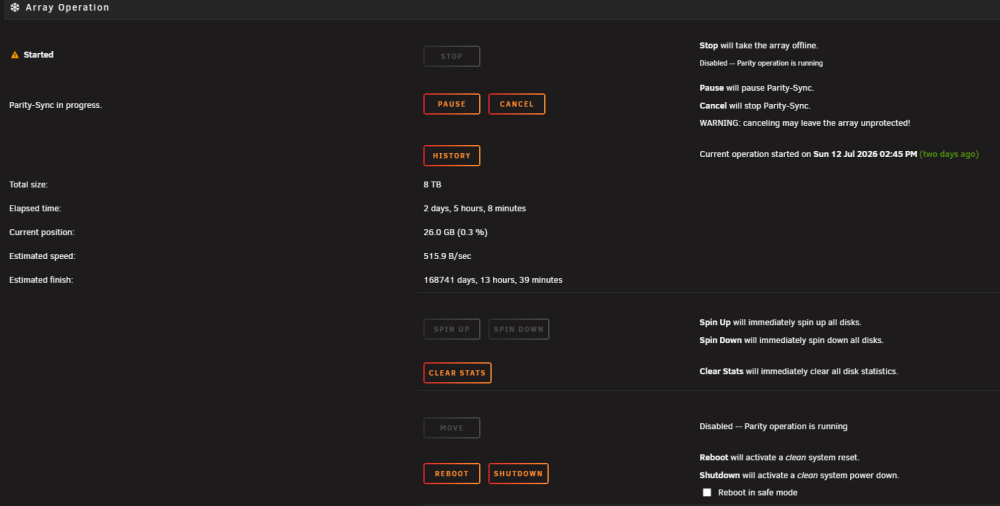

I installed a new parity drive due to the old one having sync errors being reported and now during the parity rebuild, it has been extremely slow and is now at 0.3% and has not changed in at least 10 hours.

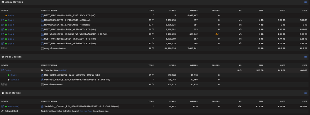

Here is a screen grab of the Array Devices
And here is the Array Operation
While typing this up, the array is now showing read errors on drive 4 so I have attached the diagnostics from just before I started typing this post and another one from just now after the read error was reported.
