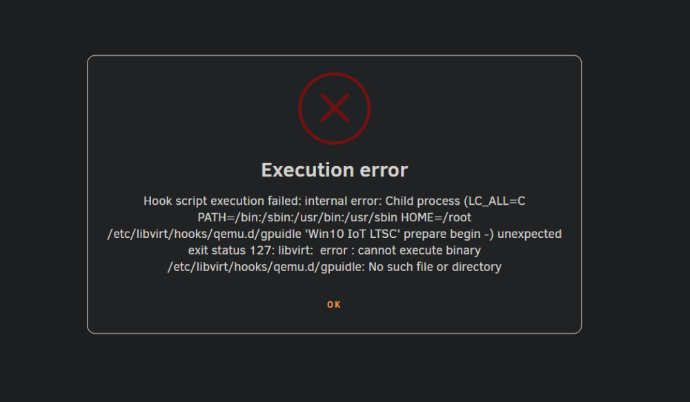

Yesterday at 08:16 AM1 day Noobie needing help here. I am trying to run a hook script to put gpus to idle after vm shutdown. But with any script I put in /etc/libvert/hooks/qemu.d/, I get this error on vm startup. I chmod everything. Even if the script does nothing, still get this error. My qemu is version 9.2.3.Script is #!/bin/bash if [[ $2 == "release" ]] then bash /mnt/user/isos/scripts/nvidia_idle fi Edited yesterday at 08:18 AM1 day by kakashisensei
9 hours ago9 hr Author 14 hours ago, Jorgen said:ls -l /etc/libvirt/hooks/qemu.dthis is what i getls -l /etc/libvirt/hooks/qemu.d total 4 -rwxr-xr-x 1 root root 98 Aug 2 01:17 gpuidle*
6 hours ago6 hr Author i am looking at this and it says i need to have folder of the vm name in qemu.d. once i put the script in vm name folder, i stop getting this error message and the vm starts. the doc states i can put the script in /etc/libvirt/hooks/qemu.d/$vmname/release/end/ and it should execute after the vm has turned off and released resources. but it still isnt working when i exit the vm. i have chmod the scripts and have tested the scripts run fine when i manually run them in terminal.
