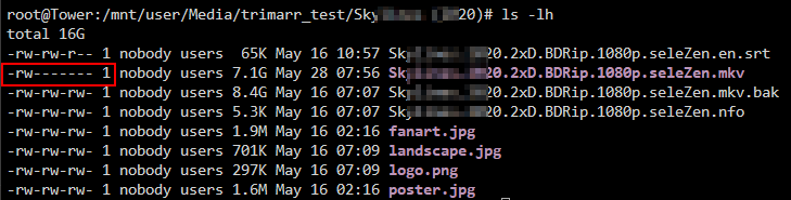

Successfully tested, permission issue resolved, thanks for the quick turnaround! Now running with backup file disabled across my full TV Show directory. Will report back if I come across anything else but looking very solid right now. Thanks again for making this avialbe, it's very useful!

@binhex I've created an issue in Github for the file permission issue: https://github.com/binhex/trimarr/issues/56

My testing continues, and I need more help! File permissions on the remuxed files are not correct for me, have I missed something in the docker setup? Edit, relevant variables from docker run command: -e 'PUID'='99' -e 'PGID'='100' -e 'UMASK'='000'
