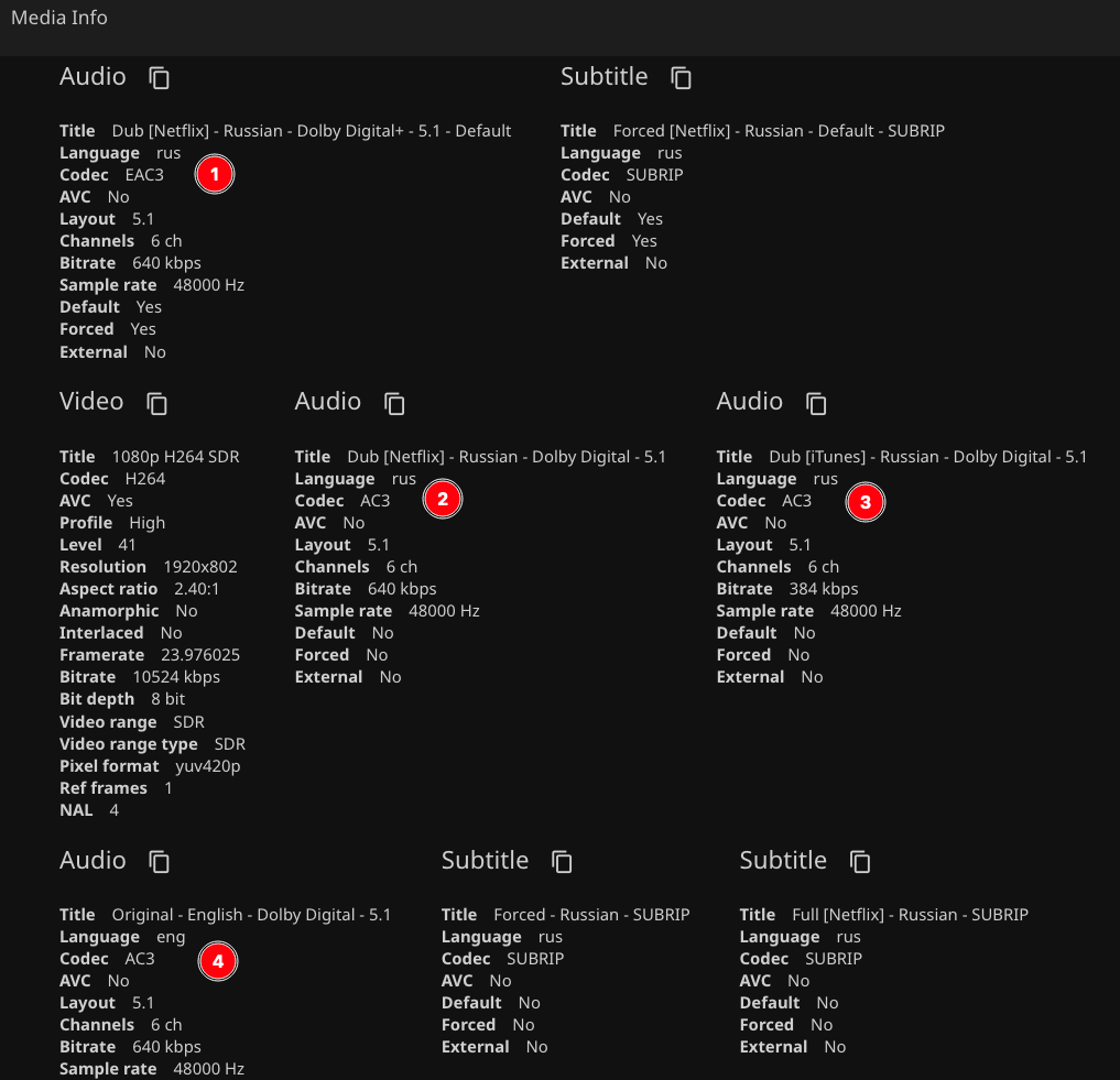

  17. Looking through the dry-run logs, I assume the audio-tracks and subtitle-tracks indexes are the items to keep after processing? So in this example it would drop 3 audio tracks and only keep the current track 4. Checking the media info in Jellyfin seem to follow the same order, does anyone know if this a reliable way to quickly check which track(s) will be kept?

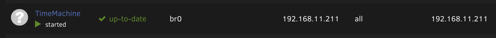

  22. I'm having a strange issue with the docker icon missing (not downloading). This is in the logs, with nothing else helpful around it: TimeMachine: Could not download icon https://upload.wikimedia.org/wikipedia/de/f/f4/Time_Machine_%28Apple%29_Logo.pngI can download that file manually using curl from the unraid cli. I've tried other urls in the docker settings as well, with the same problem. Does anyone have any ideas on what might be wrong and how to fix it? The rest of the docker works great and has been for several years. docker run command
