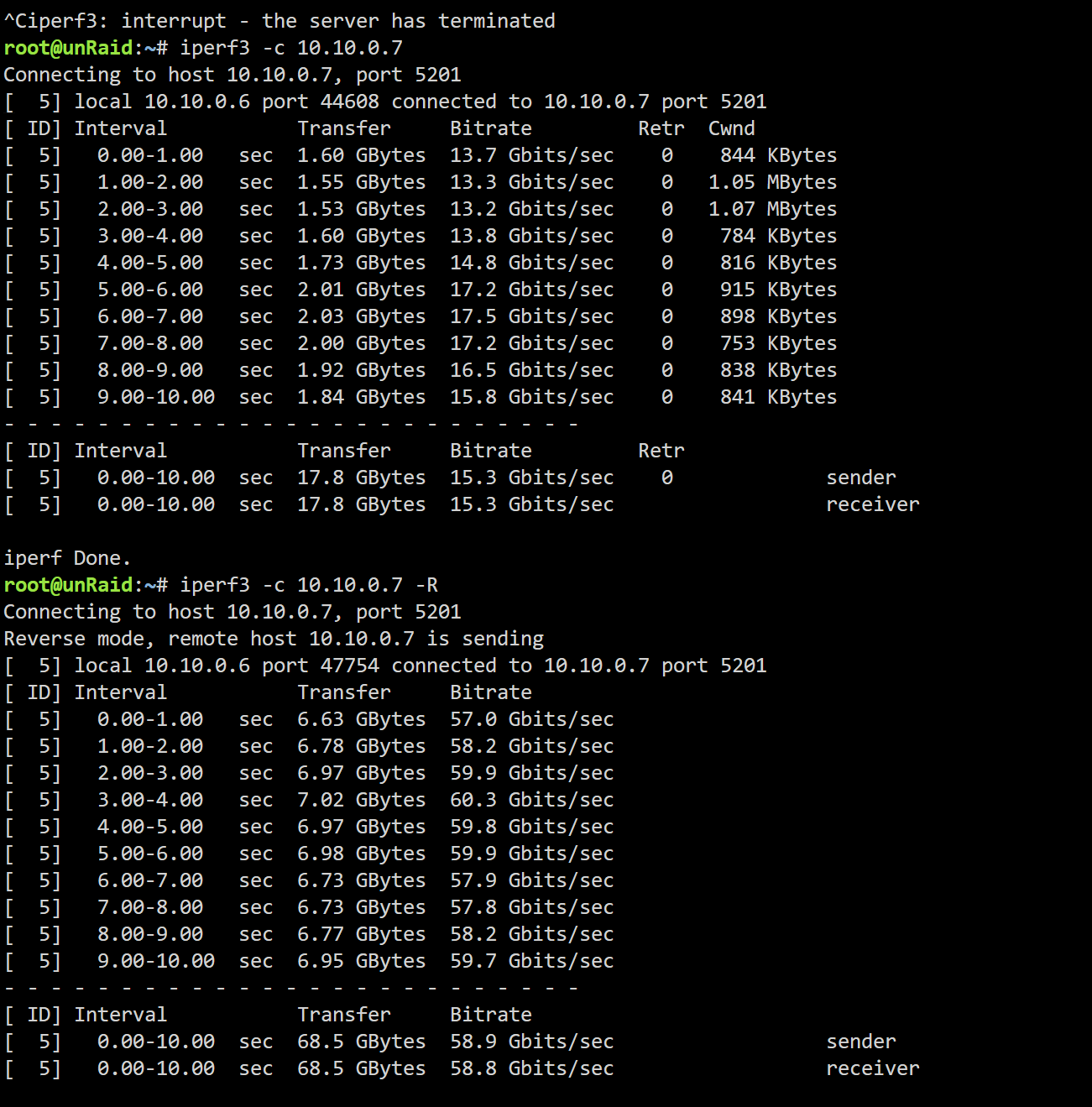

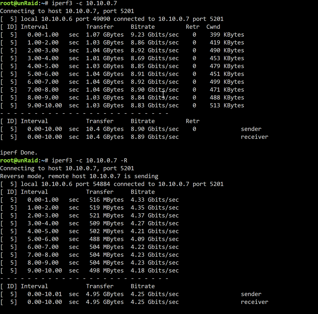

  1. Unraid 6.12.14 Cpu was idle besides this iperf3 test
  2. Here you go: virtio: virtio-net cores aren't pinned with virtio like with virtio-net. iperf3 server is on Windows 2025 VM. Also note that it makes no difference in terms of throughput with my host CPU and with my network (2.5Gbit). It did make a difference when I had i7-4790 (non-k) as my host CPU.

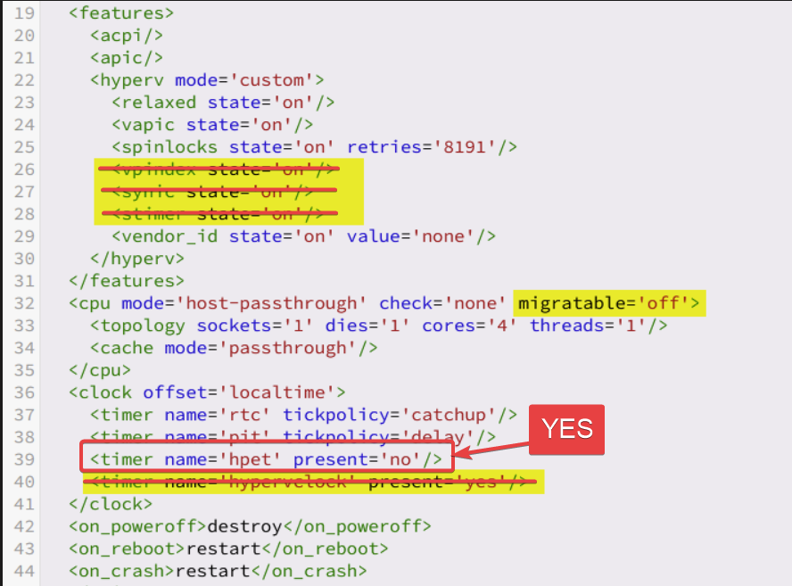

  10. Just to confirm what @trurl said. I just bought 2x Yottamaster 10Gbit/s 5 bay enclosures thinking I could reduce power usage by using the enclosures + a modent laptop. I reduced idle power usage by around 40W, however the issue with the enclosures was that it was contstantly substituting enclosure serial number for some drives' serial numbers at random every boot. So the serial number for drives would change randomly ever boot which caused unraid to think the drives are missing. After messing around for 2 days I returned the enclosures today. The speed was great. If UNRAID used PARTUUID instead of identifying the disks by-id it would likely have worked, but unraid does it by-id so it's a no go, unfortunately. I guess PARTUUID is just a partition id, so it may not be feasable.
  11. I am saying I don't believe Windows XP supports Hyper-V Enlightenments. So for XP, you would need to enable HPET timer. See below. I striked through what you do NOT need to add for XP, but change the HPET line to "yes"

  13. First try to change the machine type to Q35. i440fx does not support PCIe, just regular PCI. You need PCIe since you are passing through NVMe drive, which is PCIe If that makes no difference, try changing "threads" to only 1 and bump number of cores instead.
  14. Hi SimonF, I believe it was version 6.11.x, the version that was current at the time of writing OP. Yes, it is my understanding that that you need all of the following options <vpindex state='on'/> <synic state='on'/> <stimer state='on'/>, additionally some people reported settings migratable='off' resolved issues with GPU PCIe passthrough stutter. migratable='on' is only useful when miograting VM from one host to another, and unraid does not support it anyway so it's safe to turn it off for everyone.
