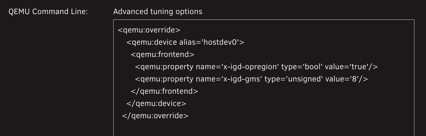

After some hardware changes, the default 'hostdev0' alias name we use in the qemu:override section got claimed by another hostdev device. And the VM failed to start. Looking into the use of alias names in libvirt, we really should be setting a manual alias for the igd device and use that in the qemu:override section. There are some rules to follow, though. From https://libvirt.org/formatdomain.html#devices Which means we should change the igd hostdev block to: <hostdev mode='subsystem' type='pci' managed='yes'> <driver name='vfio'/> <source> <address domain='0x0000' bus='0x00' slot='0x02' function='0x0'/> </source> <alias name='ua-igd'/> <rom file='/mnt/cache/domains/iGPU_ROM_files/igd_rpls.rom'/> <address type='pci' domain='0x0000' bus='0x05' slot='0x00' function='0x0'/> </hostdev> and the qemu:override to: <qemu:override> <qemu:device alias='ua-igd'> <qemu:frontend> <qemu:property name='x-igd-opregion' type='bool' value='true'/> <qemu:property name='x-igd-gms' type='unsigned' value='2'/> </qemu:frontend> </qemu:device> </qemu:override>

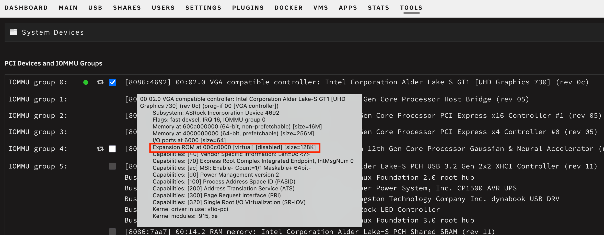

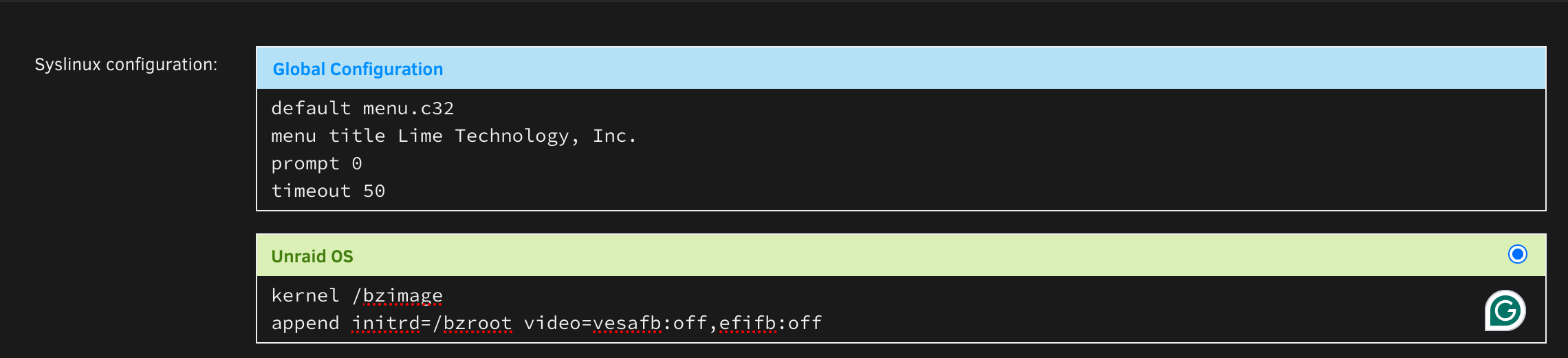

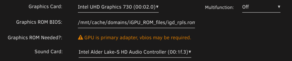

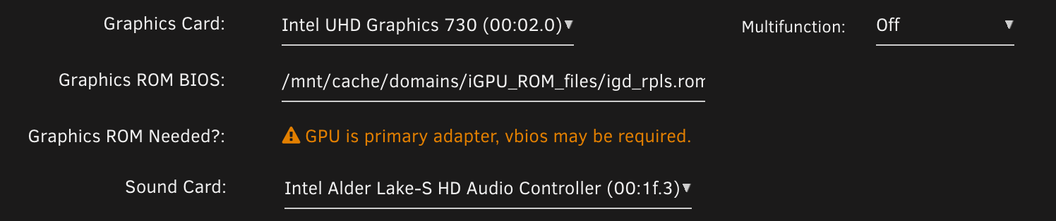

Just got this working with Q35 on Unraid 7.1.2 too! Additional steps: Addded video=vesafb:off,efifb:off to Syslinux.conf Set DVMT to 128M in BIOS For VM settings: Machinetype = Q35-9.2: <type arch='x86_64' machine='pc-q35-9.2'>hvm</type> Same custom rom files for Intel integrated GPU and soundcard: <hostdev mode='subsystem' type='pci' managed='yes'> <driver name='vfio'/> <source> <address domain='0x0000' bus='0x00' slot='0x02' function='0x0'/> </source> <rom file='/mnt/cache/domains/iGPU_ROM_files/gen12_igd.rom'/> <address type='pci' domain='0x0000' bus='0x00' slot='0x02' function='0x0' multifunction='on'/> </hostdev> <hostdev mode='subsystem' type='pci' managed='yes'> <driver name='vfio'/> <source> <address domain='0x0000' bus='0x00' slot='0x1f' function='0x3'/> </source> <rom file='/mnt/cache/domains/iGPU_ROM_files/gen12_gop.rom'/> <address type='pci' domain='0x0000' bus='0x07' slot='0x01' function='0x0' multifunction='on'/> </hostdev> Same qemu overrides, but x-igd-gms set to 4 to align with DVMT in BIOS: <qemu:override> <qemu:device alias='hostdev0'> <qemu:frontend> <qemu:property name='x-igd-opregion' type='bool' value='true'/> <qemu:property name='x-igd-gms' type='unsigned' value='4'/> </qemu:frontend> </qemu:device> </qemu:override> Getting complaints about legacy mode not supported (which is expected for Q35), but it still works. 2025-05-25T00:17:58.100378Z qemu-system-x86_64: -device {"driver":"vfio-pci","host":"0000:00:02.0","id":"hostdev0","bus":"pcie.0","multifunction":true,"addr":"0x2","romfile":"/mnt/cache/domains/iGPU_ROM_files/gen12_igd.rom","x-igd-opregion":true,"x-igd-gms":4}: IGD device 0000:00:02.0 cannot support legacy mode due to existing devices at address 1f.0 2025-05-25T00:17:58.307272Z qemu-system-x86_64: vfio: Cannot reset device 0000:00:1f.3, no available reset mechanism. 2025-05-25T00:17:58.548189Z qemu-system-x86_64: vfio: Cannot reset device 0000:00:1f.3, no available reset mechanism.

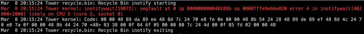

9 hour memtest, 6 passes, no errors. That's the longest I can do, need to bring the server online again. After reboot, segfault error again. This is the only mention of any segfault in the logs.:

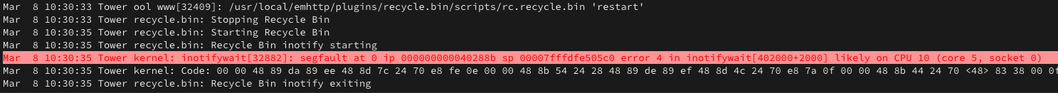

I'm just adding that I'm also getting an inotify segfault after upgrading to 7.0.1 today (and a plugin update). Happens on plugin start, and also plugin restart as shown here:
