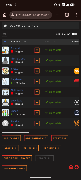

Hi everyone's,
I have just updated to 7.3.3 from 7.3.2 and at the restart i have lost 80% of my docker app.
The folder has remained but there is no app.
Can someone help me understanding if there is a way to restore them and why the got lost?
