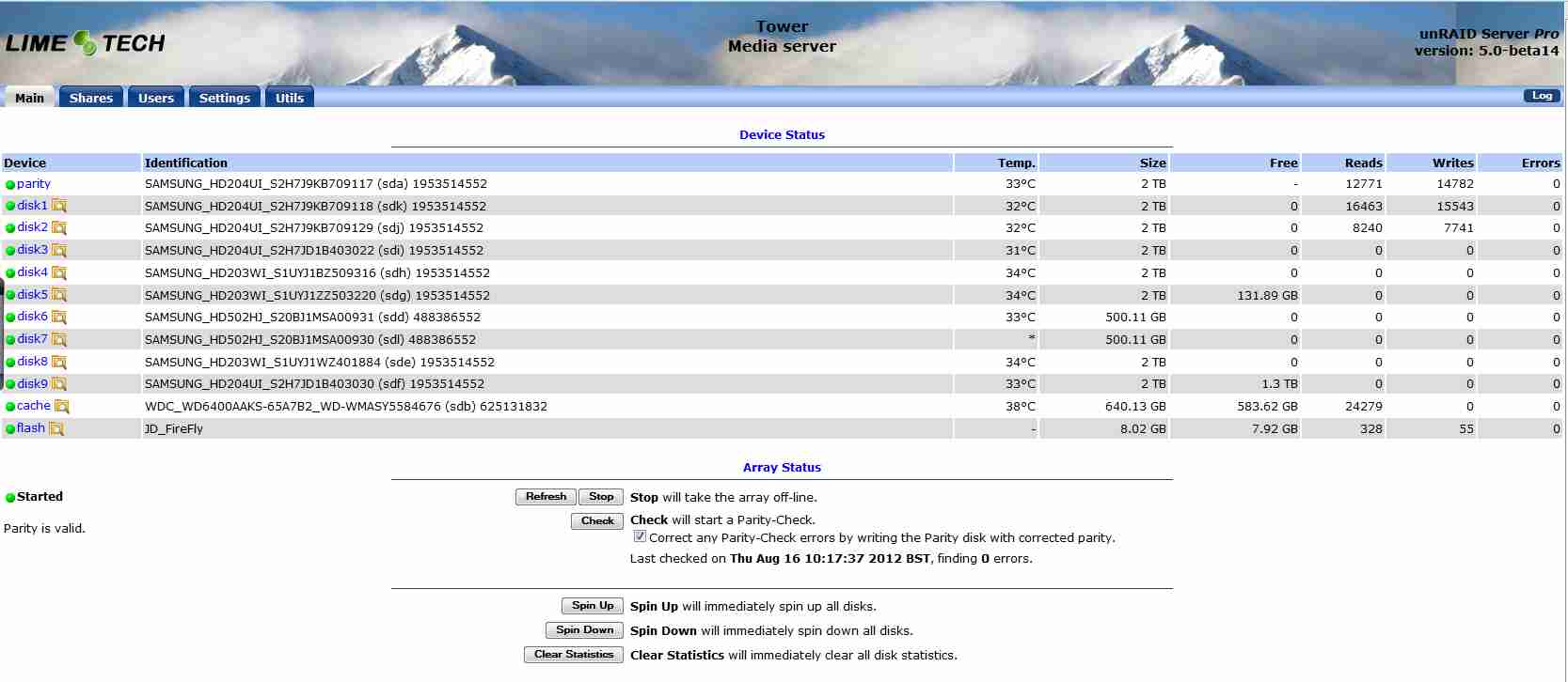

August 17, 201214 yr Hi everybody. I have some odd problems with my unraid system. I have several hdds in my unraid array. I tried to move a folder "downloads" from my PC to my download share on unraid. First, it was copied to my cache drive. I invoked the mover app to move the files. When I checked the process some hours later, I saw, that there where still some of the files left on the cache drive. Disk 1-8 is full, disk 9 has still more than 1 Tb space left, normally enough for the 57 gb which are left to copy on the cache drive. But the mover refuses to copy the files to that drive! Share Settings folder Download: Allocation: most-free min free: 10000000 split: 4 I always get the following error report: Aug 17 19:37:31 Tower emhttp: _shcmd: shcmd (84): exit status: 1 Aug 17 19:37:31 Tower emhttp: shcmd (85): /usr/local/sbin/emhttp_event svcs_restarted Aug 17 19:37:31 Tower emhttp_event: svcs_restarted Aug 17 19:37:43 Tower emhttp: shcmd (86): /usr/local/sbin/mover |& logger & Aug 17 19:37:43 Tower logger: mover started Aug 17 19:37:43 Tower logger: moving Downloads/ Aug 17 19:37:43 Tower logger: ./Downloads/test/folder1/test.iso Aug 17 19:37:43 Tower logger: .d..t...... ./ Aug 17 19:37:44 Tower logger: .d..t...... Downloads/test/ Aug 17 19:37:44 Tower logger: >f.stpog... Downloads/Downloads/test/folder1/test.iso Aug 17 19:40:21 Tower shfs/user0: shfs_write: write: (28) No space left on device Aug 17 19:40:22 Tower logger: rsync: writefd_unbuffered failed to write 4092 bytes to socket [sender]: Broken pipe (32) Aug 17 19:40:22 Tower logger: rsync: write failed on "/mnt/user0/Downloads/test/folder1/test.iso": No space left on device (28) Aug 17 19:40:22 Tower logger: rsync error: error in file IO (code 11) at receiver.c(302) [receiver=3.0.7] Aug 17 19:40:22 Tower logger: rsync: connection unexpectedly closed (34 bytes received so far) [sender] Aug 17 19:40:22 Tower logger: rsync error: error in rsync protocol data stream (code 12) at io.c(601) [sender=3.0.7] What can I do? As attachement I put some pictures of my Unraid config and my syslog. Thank you for your help! Marco syslog.txt

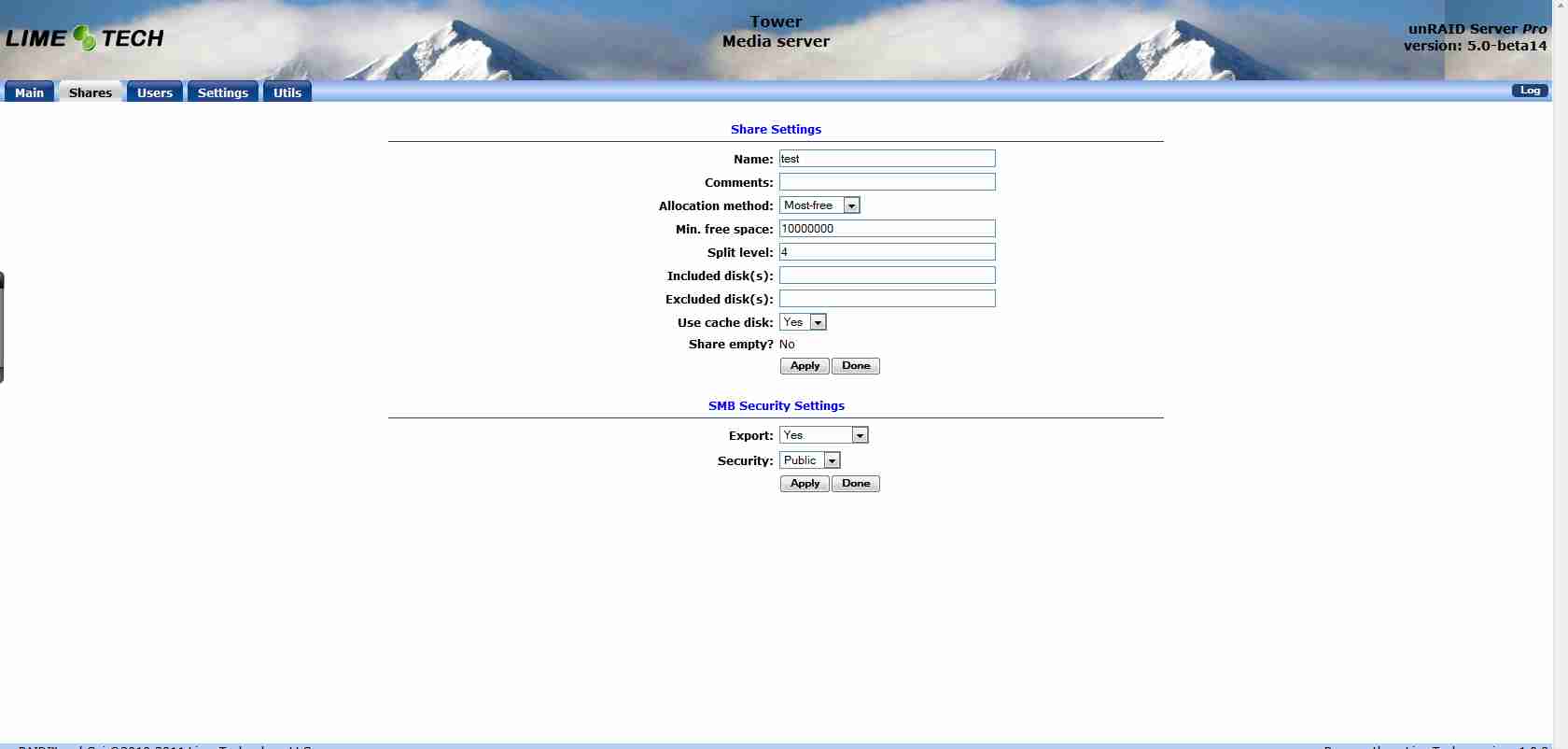

August 18, 201214 yr Author The ISO file is aprox. 8,5 gb big. for the share config, take a look at the jpeg below ;-)
August 18, 201214 yr Asked previously, but not yet answered. What do you have in "Setting->Share settings?" Are any disks included/excluded there?
