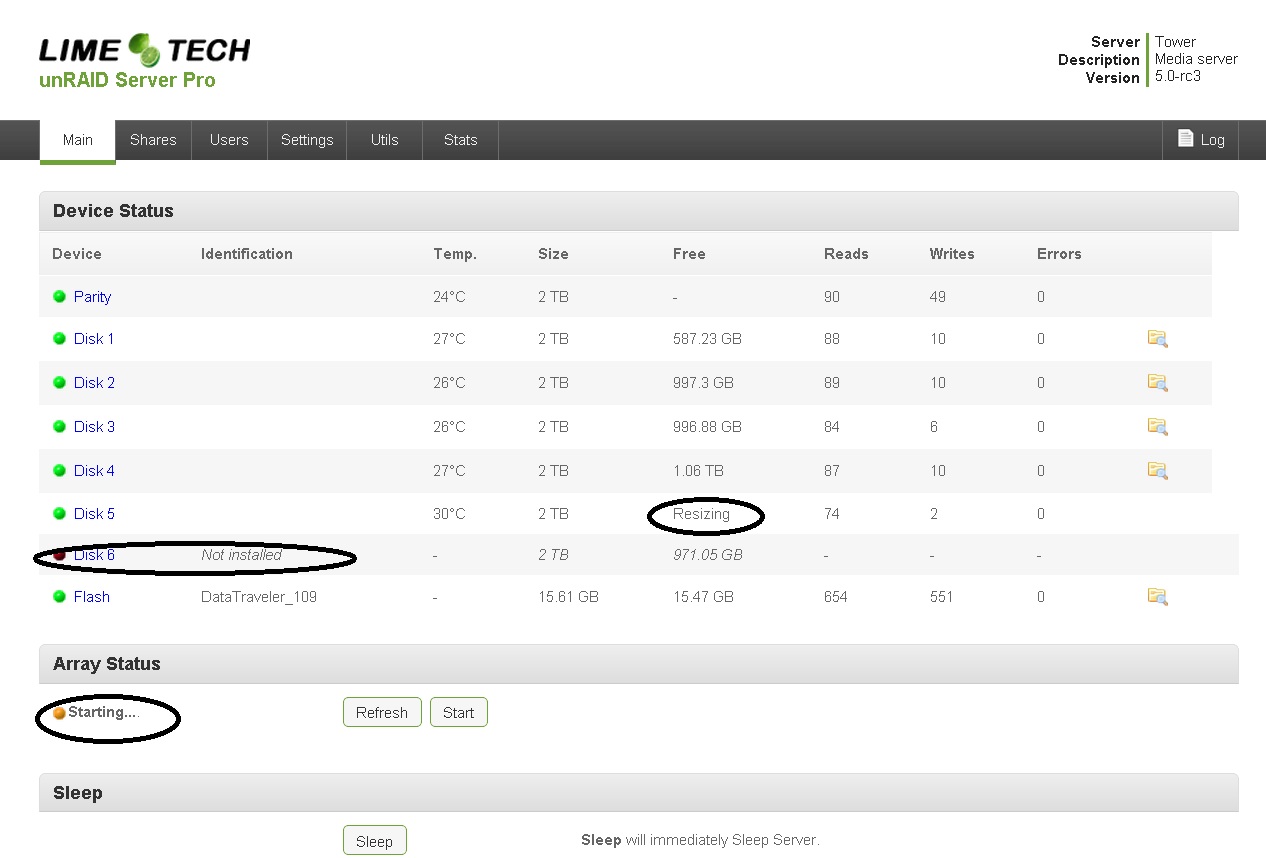

Hi there, my box was stuck at "Starting..." with an amber coloured ball beside it, I tried to fix it by rebooting and plugging and unplugging drives, now it still says "Starting..." with an amber ball, plus now one disk is stuck at resizing, and another disk says "Not Installed", when I go to the server using http://servername:8080 it shows the drive that is reszing to be okay, but the "not installed one" has "DISK_DSBL_NP" in red font, can anyone help me bring this thing back on line? thank you

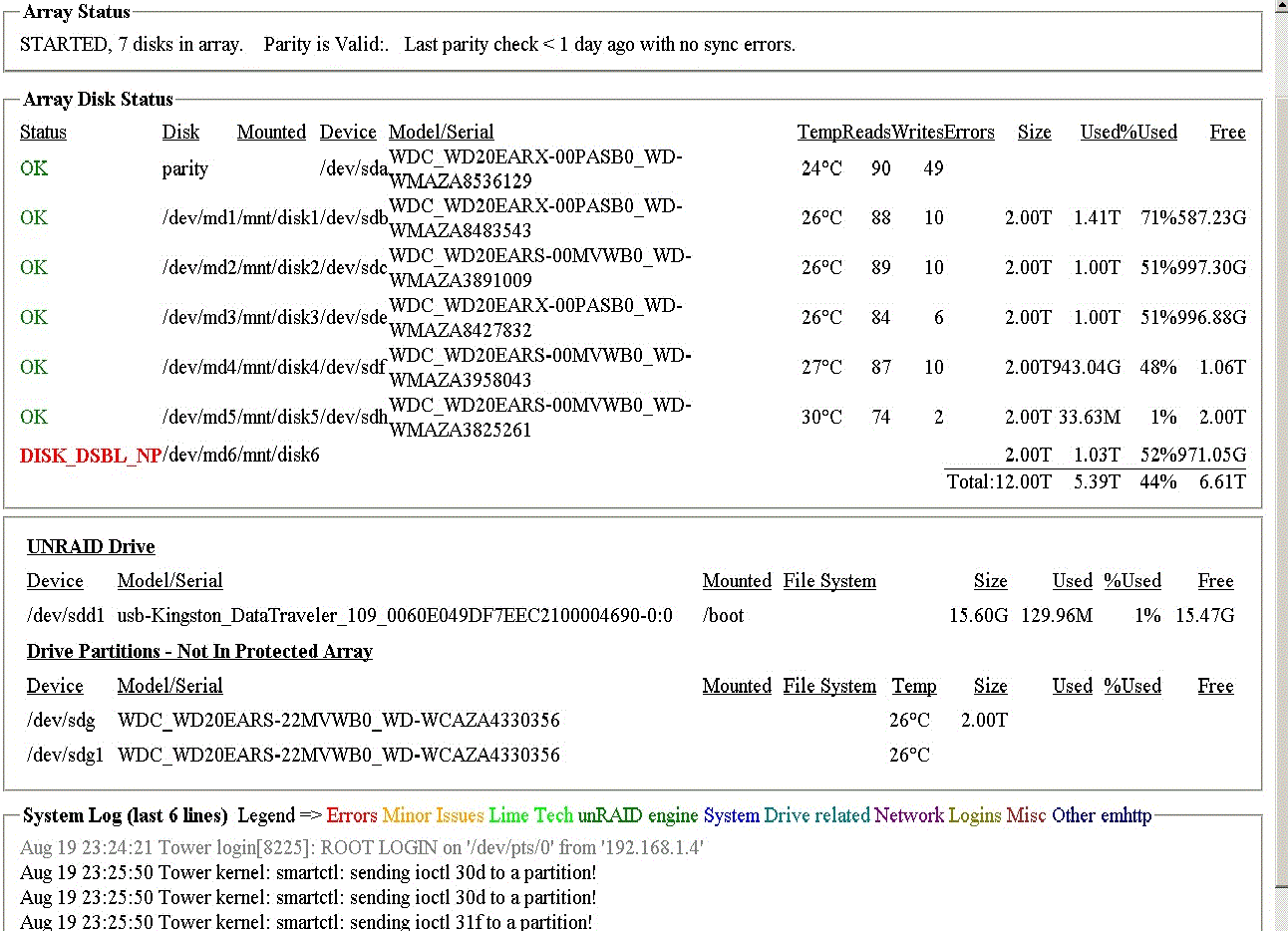

this is the capture of unmenu

Well,looks like disk6 is not present.  Replace it.
okay I took it out and I have a spare 2 TB that I have that I will use in it place, but since it was dead anyways i added it to my windows machine and installed DiskInternals Linux Reader, I can still see the contents, and I'm currently backing it up, doesnt that mean that the drive is not dead?
Well,that then indicates a possible issue with the disk controller,or cables, or drive tray in your unRAID server.
the cable was replaced, there is no tray, there is no 3rd party controller I'm connecting directly to the motherboard, I'll try a different port
