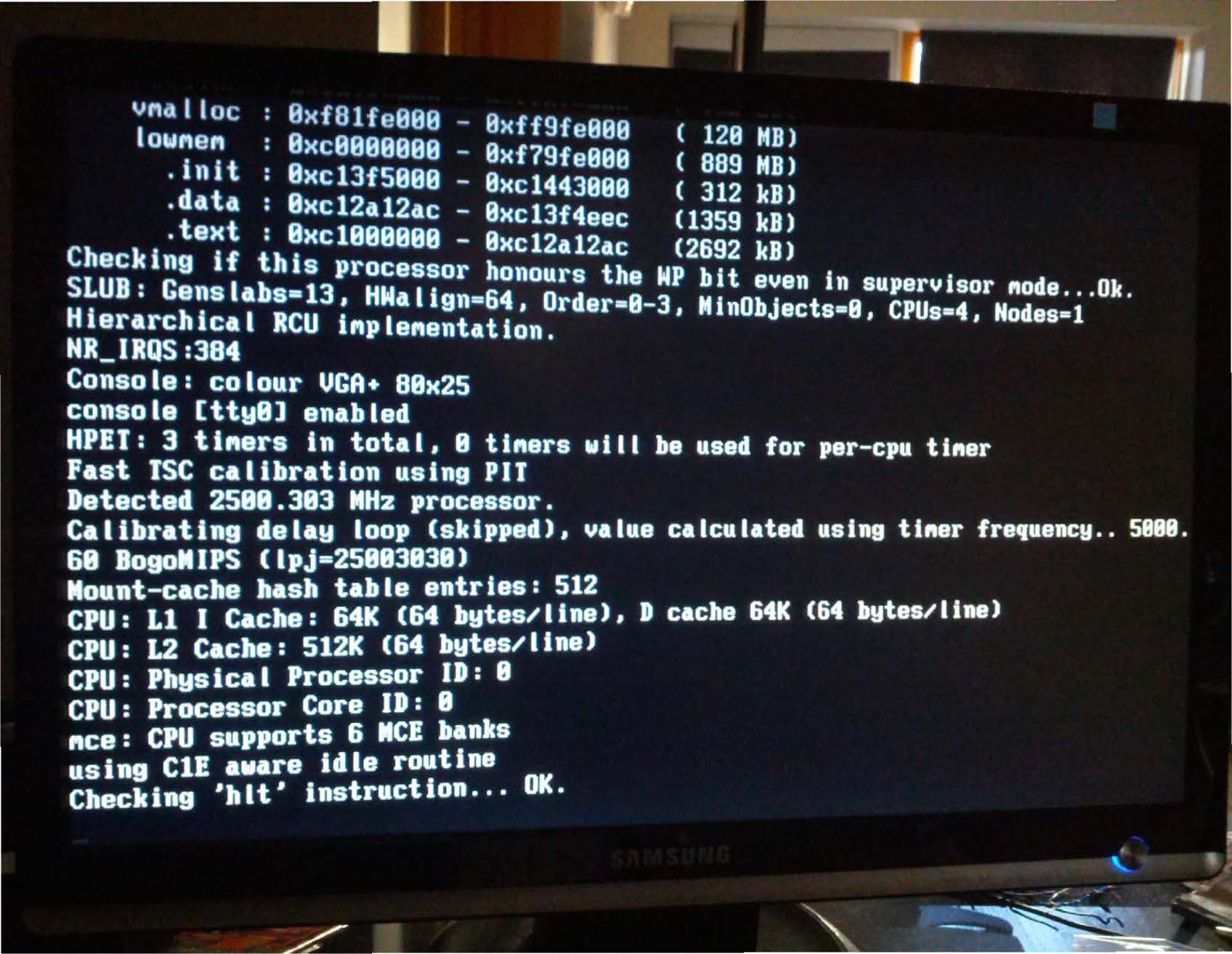

I got the computer speaker, and turned the computer back on, and I got video output. Not sure why I get output all of the sudden. However, upon booting, it hangs at the same spot, after "Checking 'hlt' instruction...OK. I removed the expansion card, so the setup is the same as I've had for a while, which has had no problems. Any suggestions would be greatly appreciated. I have attached a couple images of the screen at hang up. Thank you.

Using an editor that DOES NOT put MS-DOS style carriage returns on the ends of lines, open up the syslinux.cfg file on the flash drive  (It will probably be a hidden system file, so set your file explorer to show thosefiles),
Then append no-hlt to the end of the "append" line as shown below, then reboot.  The boot process will then skip the test of the "hlt" instruction not properly handled by some older AMD processors.  This may result in a different error further into the boot process, but you'll be able to report back how it acts.

Thanks for the suggestions. I appended the "no-hlt" to my pro usb. It got past where it was sticking before, but ended up freezing elsewhere. I restarted it a few times, and it froze up somewhere different each time. After restarting 4 or 5 times, I got no video output at all, and no beeps. I got not beeps after booting with memory, either. After fooling around and seating/unseating memory and unplugging all hard drives, I got it to boot. However, it froze at "Booting Kernel". I restarted and it booted at the same spot. I switched out the USB for the free version, and that froze part way through the starting "bzroot" load, after several ".........". I shut down the computer and started it again, but once again I have no output or beeps. Could this be a problem with the mb? Thanks.
