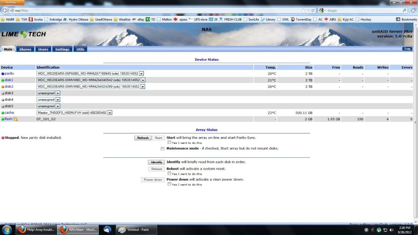

Here's a screenshot of how things look...

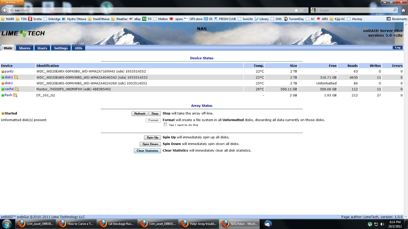

Array...
