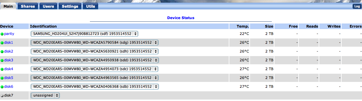

I ran the reiserfsck with --rebuild-tree. The GUI now shows drive 4 with a red ball and 2 errors.
I tried to run smartctl and It's just giving me errors attempting to run it.

Is it safe to assume it's actually the drive? I found I was able to run smartctl against the other drives in the array. Is it safe to unassign the drive and start the array?
I wanted to add the new dmesg log
http://pastebin.com/VzGHQite
Lots of bad looking stuff at the bottom.
First power cycle the system and see if disk 4 will provide a SMART report. Un-assign the drive and start the array. You may need to run reiserfsck --check /dev/md4 at this point. If disk4 does not respond to smartctl it will need to be replaced.
I rebooted the machine and power cycled it. I was able to run the smart report, and it show's FAILING_NOW on pre-allocated sector count.

I am going to unassign the drive and start in maint mode then run the reiserfsck on the drive?
