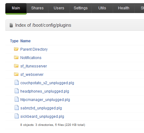

September 22, 201214 yr Influencer, I just upgraded from 4.7 to 5.0rc8a with Simple features. I've put your plugins into flash/config/plugins and reboot the tower. It doesn't appear that anything installed. So I checked out your install guide here: https://github.com/Influencer/UNplugged/wiki/How-to-Install-Plugins and connected via telnet to run 'installplg /boot/config/plugins/sabnzbd_unplugged.plg', there was an error 'xml parse error'. Do you know how to get past this?
September 22, 201214 yr Author I just did that again, please see my screenshot of the directory structure and files. I restarted once again. They are supposed to appear in the Settings tab, correct?
September 22, 201214 yr yes they should appear in the settings tab. Did you try running installplg again? You can rename one to .txt and attach it to your next post so I can make sure it downloaded correctly.
September 22, 201214 yr Author I hadn't run installpkg again but just ran it and received the same error. I've attached the sabnzbd install as a text file. Thank you for helping me out sabnzbd_unplugged.txt
September 22, 201214 yr I hadn't run installpkg again but just ran it and received the same error. I've attached the sabnzbd install as a text file. Thank you for helping me out You still downloaded the wrong link. Save from these links: Couchpotato Sabnzbd Sickbeard
