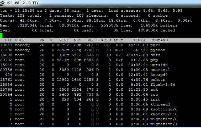

I've noticed that when sabnzbd is either repairing or unpacking, unraid in general runs very slow and sometimes the web interface hangs up. I will attach a screenshot of top displaying my processes at the time and one of my system specs.
Edit: I used this system with Windows 7 and didnt experience these issues. One other thing I forgot to mention is something I noticed last night while watching a move over XBMC which I've never experienced. While watching the movie, sabnzbd was unpacking/repairing and my movie kept buffering over and over. I had to pause the movie for a while until it finished. I've also just added a syslog.

So is there a way to force sabnzbd to slow its role in unraid? That way it wont use so much system resource when it's unpacking/repairing.
So I think I figured out my problem with SABNZBD but I believe I created more problems. I only had an 80GB cache drive so I had my downloads set to the share so I believe that was bogging down everything according to some other posts I've read. I put in a bigger cache drive and tried to copy everything over and it all went pretty good except for mysql newznab stuff. I'm putting the mysql data path back to where it was now to see if I can get it up and going but if anyone has any suggestions on moving mysql data to the cache drive and getting this thing going, I think I'll be doing good for a lil while.
Alright, I have wiped all mysql and newznab from my unraid and reinstalled. I dont backfill so it's not like anything is lost. I believe my problem is fixed although I now have one more problem which I'll try to figure out. If needed, I will come back to the community and get more help. Thanks, I couldnt have done this without you.  8)
