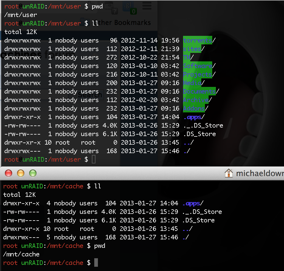

Also i have attached a screenshot of the location of my .apps folder and how it gets copied across into my array.

It's easy to explain what you're seeing. You're looking in the wrong spot. /mnt/user is a combination of the data on all the disks including the data on the cache disk. Your screen shot doesn't show anything unexpected.
Look at /mnt/user0 or the individual disks eg /mnt/disk1 if you want to see what's only on the protected array and not the cache only stuff.
