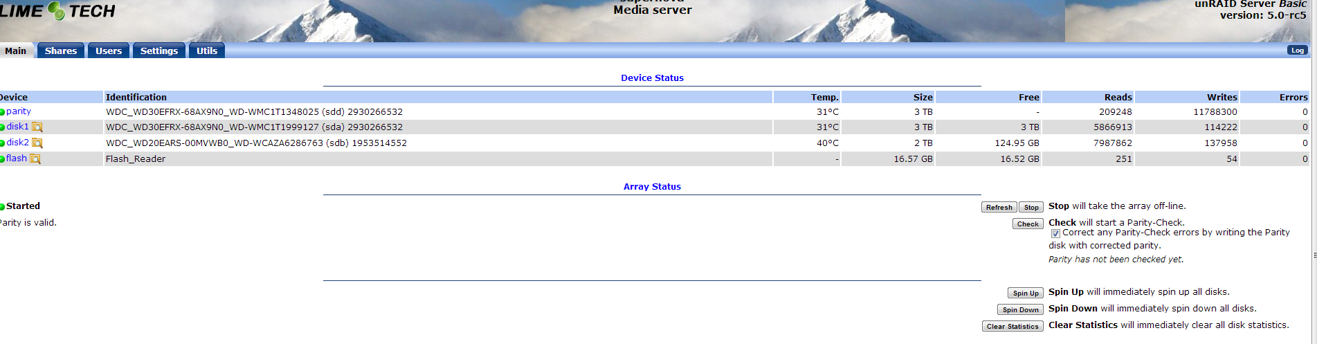

Post a screenshot of unRAID main so I can make sure I know what your current situation is.
here it is,  attached,  thanks for the help.
Write down the serial number of the old drive. Cleanly powerdown, connect the old drive and reboot. If everything still looks good then proceed.
If you have unMenu installed you can probably just look there to see the old drive. If so, post a screenshot. If not:
Take a look at this wiki entry. There is a command there we will use to determine the drive letter that got assigned to the old drive. From the console or telnet session do
ls  -l  /dev/disk/by-id/[au]*  |  grep  -v  part1
You should see the old drive's serial number in the list with some other stuff after it ending in sd and then a letter. This will be the drive letter of the old drive. Let me know what you get. If you can, post a screenshot of these results, or just another screenshot of unRAID main
