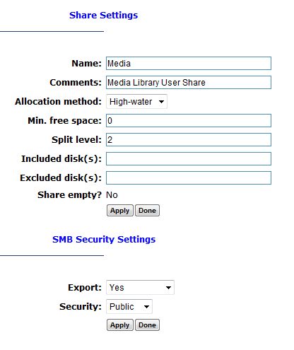

I've attached a screen capture for the options I see for restricting access.

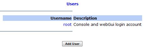

I also tried to set up a new user (myself.) I was able to input my information including user name and password and hit apply, but I never see the user listed??

If you aren't getting the user added it might be because of the username character restrictions
If you manage to get users added, then you will be able to choose Security: Secure and specify which users have read/write and which only have read access.

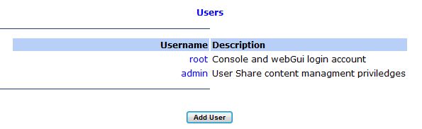

OK - Well that was it for setting up a new user. Good call!
I would like to keep the access very simple and avoid the need to create user names and passwords except for the one I've set up for myself.
I read in a couple of threads a setup where the shares were visible and readable by all users but could only be read and written to by one user (in this case myself)
I've attached a screen shot of my new user "admin" and would like any other device / uer that is mapped to the share to find and read the contents but not be able to modify (write).

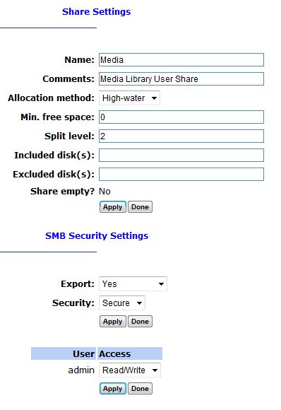

OK,
So I've setup the following: (see attached)
Will this setup provide "read only" access to every who is mapped to the share and "read / write" access to "admin" only?
Yes I think that should work.
More detailed explanation of share security setting can be read here.
That seems to have done the trick.
All shares a able to read / play media files from the shares.
