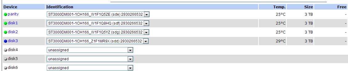

Finally had a chance to take the cluster down today and try to add the disk again.  Attached is the syslog.  I only attempted to add a single disk this time around, and it actually does ask if i want to record the new info and add to the array but it is stuck at that step (reloads the page with the same question, no matter how many times i say "yes, do it").
I also attached pictures, though i'm not sure they'll be a huge help.  Everything looks like it should work, so i don't doubt i have something oddball in my specific implementation.  I'm running the latest version (5.0-rc11) because i couldn't get the 3TB drives to show up in the previous version.

Did you check the checkbox to enable the "Start": button and then press "Start" to start the array?
Here is your issue:
Mar  3 00:07:03 DataStore logger: sgdisk: /usr/lib/libstdc++.so.6: version `GLIBCXX_3.4.11' not found (required by sgdisk)
Did you by chance load any add-on or plugin packages that might have put into place a different version of the libstdc library?  If so, disable your plugins, (they are breaking the unRAID system commands) and reboot, and then add your disk.
Then, you can go back to the authors of the plugin(s) involved to let them know their add-on is breaking the sgdisk command (and probably other things too) in your versions of unRAID.

Yup, it was an addon.  One I hadn't even realized i had loaded (called "unRAID-Web").  I pulled all of my addon's off one-by one, found that one (literally) at the bottom of the list, and after it came off (and rebooted) i could add disks again.  Never used it, so i won't miss it.
