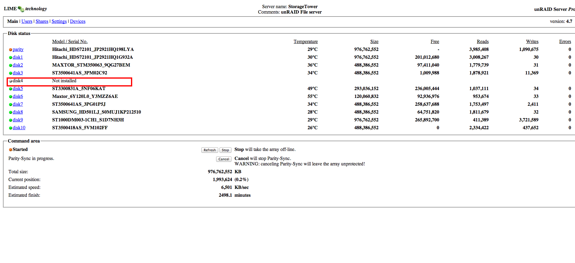

I am in the process of the first parity rebuild now and I noticed that it lists the missing disk (disk4) as "not installed" (see attached screenshot).  I assumed that the missing disk would just not be listed.  hopefully that is not an indication that i did something wrong.
So I believe that I have to remove one drive from the array at a time right?
Nope. You can remove all the drives at once, and the initconfig will rebuild parity based on all remaining assigned drives. Since you are rebuilding parity, it really doesn't matter which slot is which as long as you reallocate the desired share includes and excludes, so you could remove all your empty drives, reassign all the drives you are keeping to contiguous slots and be done after a successful parity generation and subsequent check. The reason slot 4 shows as not installed is that you unassigned it. You could have just as easily unassigned your last drive slot, assigned it to slot 4, and generated parity from there.
