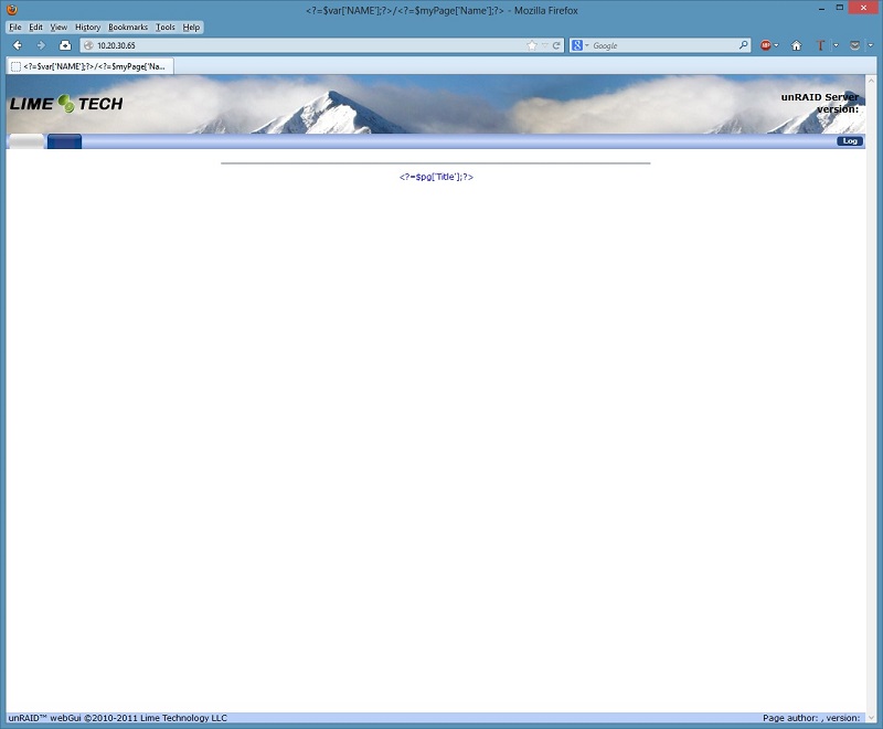

I just upgraded from 4.7 to the latest RC and when I access Unraid, the webgui is malformed and broken (see screenshot).  I followed the upgrade instructions below:

Thanks, just tried that but same result with different browsers after purging cache.

The issue is your add-on "php" web-server.  It does not have "short tags" enabled.
Type
php --ini
to locate the php.ini file location
then type
sed -i "s/^short_open_tag = Off/short_open_tag = On/" /boot/custom/php/php.ini
substitute your php.ini file location for the one listed here above in RED.  then, you should be back working.
OR
do not install an alternative version of "php"as unRAID has one already.
Joe L.
That fixed it, thanks!
