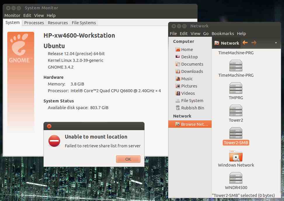

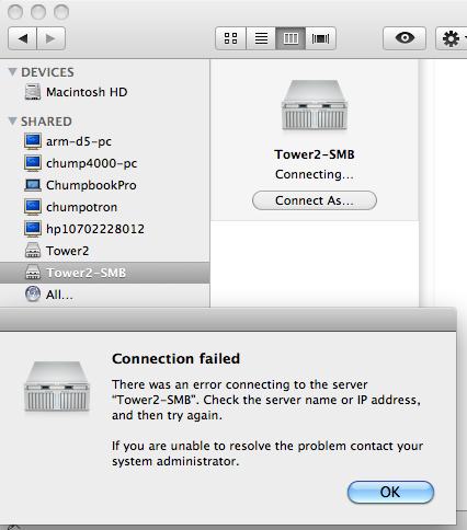

In all cases I can still use the AFP/Time Machine to backup my Mac, but attempts to access smb shares all fail, even though I can see 'Tower2-SMB' listed when I browse the network. Is OSX I get a connection failed and a pop up telling me to contact my system administrator (see attached). Under Linux I get a 'Unable to mount location. Failed to retrieve share list from server' pop up (see attached). In both scenarios I do NOT get asked for credentials.
