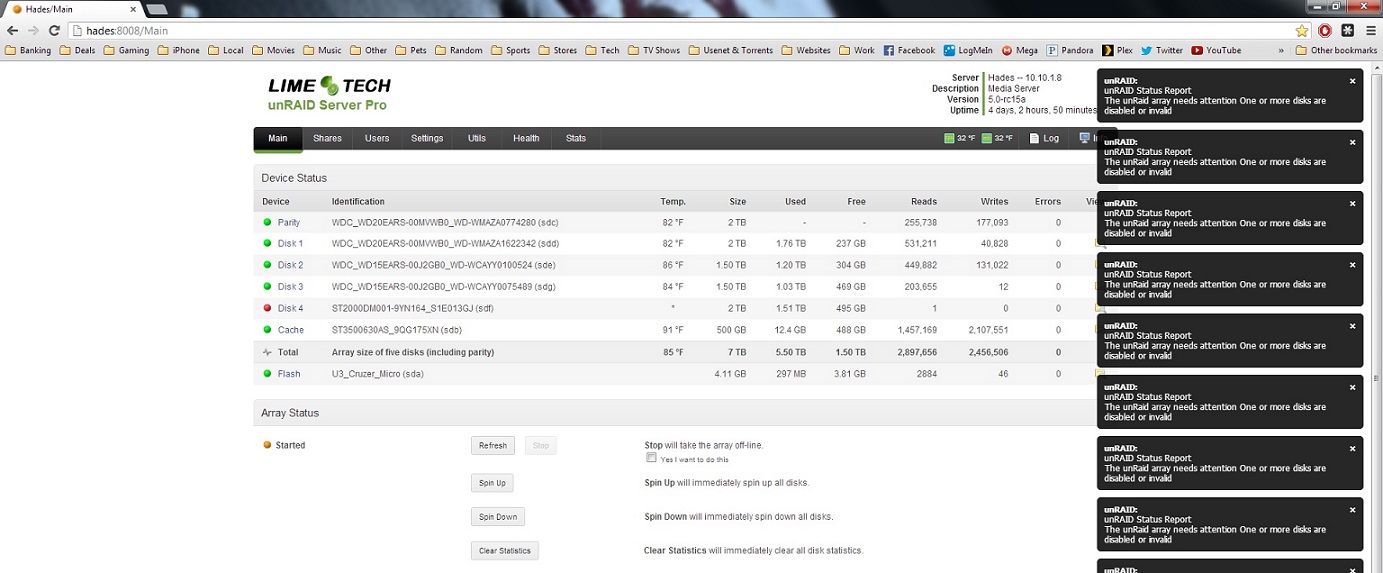

I'm not sure what you're saying here.  Post a picture of the Web GUI [Alt-PrtScrn, then paste it in Paint, then save it as a JPEG, and then attach it to a post here].    The array SHOULD go online with no problem, even with a failed disk ... but parity should still be valid, and the failed disk should have a "red ball" next to it.  If that's the case, then you should definitely do the swap-disable process as soon as possible, as you're running "at risk" until that's done.    [A better approach would be to replace the failed drive with a 2TB drive, so you don't have to simultaneously replace the parity drive; but that would require buying another drive.]
I attached a picture, I plan to do the "Swap both" as I don't want to purchase another drive at the moment. That being said, I haven't done this for about a year now, how do I pre-clear these drives prior to unRAID just detecting them? Can I do that? Do I need to do that? I assume pre-clearing 2 4TB drives will take 4-5 days...

Actually you have good parity, which is WHY you can still access the missing drive (it's emulated by the other drives) and why you can rebuild the drive by simply replacing it.
You can do the swap-disable process ... but do NOT wait on this.    ANY other failure and you'll not be able to recover the data from the failed drive.
