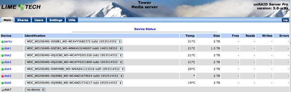

September 24, 201313 yr So i got this red ball on a disk right after the power went off and i got to restart the server. Not sure what to do from here because i got the server up and running long time ago and i don't have much experience on this. Any advice would be appreciated SS and syslog attached, thanks in advance! syslog-missing5.txt
September 24, 201313 yr First, get a UPS => that should be a mandatory accessory for any server. Then you'd never lose power -- it would always shut down gracefully if the power was out for more than a few minutes. Second, the red ball indicates that UnRAID has disabled the drive. Shut down; check the cables to that drive -- unplug them, then replug them to be sure they're firmly attached on both ends. If the drive's in a caddy, unplug it; then re-seat it. Now turn the system back on and see if it's still red-balled. If so, then Stop the array; unassign the drive; Start the array; Stop the array; Re-assign the drive; then Start the array again. It will now rebuild the drive (to the same physical drive). If that succeeds, you're done. If it fails, you need to replace the drive.
September 24, 201313 yr Author Ok i checked all the cables unplug them and re plug all again. Did all as indicated, got the blue dot, assigned again, got the orange dot and now the system is rebuilding on the same disk. Did I miss something? Should be done in 5 hours, so i'll be back to report later. Thx!
September 24, 201313 yr You didn't miss anything ... that's exactly what you want it to do (rebuild it on the same disk). As long as it finishes error free, you're good to go. When it's done, run a parity check.
