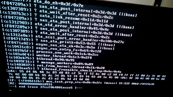

I upgraded to the latest 5.0 release as you suggested (and also to the RC16 after the 5.0 failed), and in both cases the server wouldn't boot up at all (see attachments). Seems to be a hardware issue, BUT, going back to RC10 works fine (other than the original issue where a drive would be knocked offline during heavy reads).
Any help would be greatly appreciated (to confirm if it's a hardware issue or whatever).

Did you prepare a clean install? Backup the flash and then format.
Yes absolutely. I tried the "official" way by reformatting the flash drive, and I also tried the advice on the forums (copying over the bz*, readme.txt and syslinux.cfg files). Exact same behaviour in all cases.

My thoughts exactly ... I'll start ripping out hardware and try booting the new OS version until I find the troublesome component ... thanks !!
UPDATE: removed HP SAS expander and used a combination of 2 x MV-SAS cards + Motherboard SATA ports instead, and all problems went away. Seems as though the HP card is faulty.
