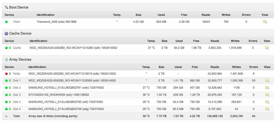

Hi everybody,
I have done searching to no avail. All of sudden I have noticed that my parity Drive has a red ball and 9 errors with disk one green ball but with 55 errors. I have tried to stop the array but lost the http connection to the server's GUI. Before losing the connection I tried to run a smart short test on my parity drive and got a line saying "smartctl: device read identity failed (not an ATA/ATAPI drive). A mandatory smart command failed, exiting".
What should I do next? Please find attached my syslog.

Hi everybody,
And the screenshot of the GUI screen.
Let's see...
The parity disk has stopped responding.  (and writes to it failed taking it off-line, making parity invalid)
It could be
1.  A bad drive
2. A bad cable to the drive (either POWER or DATA)
3. A loose cable to the drive (either POWER or DATA)
4. A bad disk controller port
5. A power supply insufficient to power all your drives (and the parity drive has shut itself down and will not respond)
6. A fan that has stopped working, and the parity disk has shut itself down after it overheated.

Thank you very much. I checked the cables and power, could not find anything wrong. Stopped the array, unassigned the parity disk, started, stopped the array, assigned the disk and let the parity build. Everything seems to be ok, some random check on the files turned out ok. The smart test on the disks (Disk 1 and parity) and the file check passed.
I don't know what went wrong and feel a little bit uneasy know. Should I change the Disk 1 or the parity to be on the safer side, or just ignore what has happened, I don't know.
