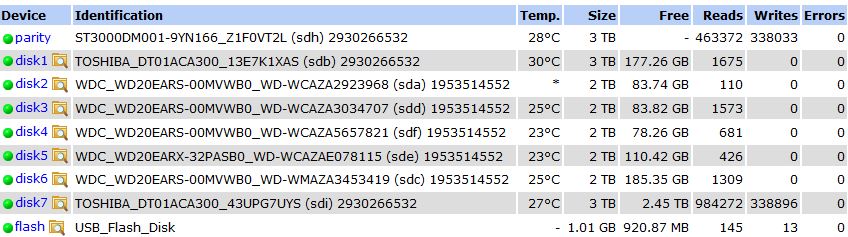

I would be grateful for advice on my Unraid 5.0-rc12a system with 8 drive array - main page capture attached.
No problems with system for 5 months. I checked parity a few days ago with no errors and then after loading 80GB I noticed a redball and 270 write errors on the parity drive (Seagate ST3000DM001).
