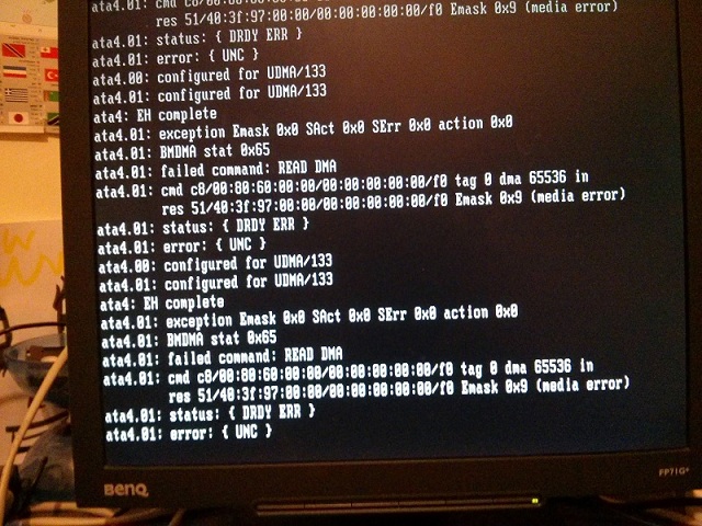

After a power fall (for some reason the APC UPS didn't helped) the sever (4.7) went down. Trying to bring it up failed. The error message goes like that:
ata4.01: failed command: READ DMA
ata4.01: status: { DRDY ERR }
ata4.01: error: { UNC }
and so on.
Please see attached screen picture.

Zip up and post a full syslog. It looks to me like you have a drive failing.
It is not a DMA error, that just means that reads are using the DMA channels, as they should, completely normal.  And it has nothing to do with the motherboard or memory or PCI.
The important flags are the 'media error' and 'UNC' (UNCorrectable sector info), which means you have bad sectors which need fixing.  Add a SMART report for the drive associated with ata4.01 to the syslog you post.  If you aren't sure which one that is, try collecting SMART reports for all of the drives, and include in the zip.
This may be the best kind of unreadable sectors, if they were caused by a power spike (at the beginning and/or end of the power outage) while the drive was being written.  That tends to scramble data, making the sector unreadable, but usually the platter media is not damaged, so there isn't anything wrong with the drive.  Forcing a drive rebuild causes the data to be rewritten in place and clears the errors.  Hopefully that is all you will have to do.

Apparently all I have to do is to wait for several moments until the system will boot. Now I can handle the defect.
