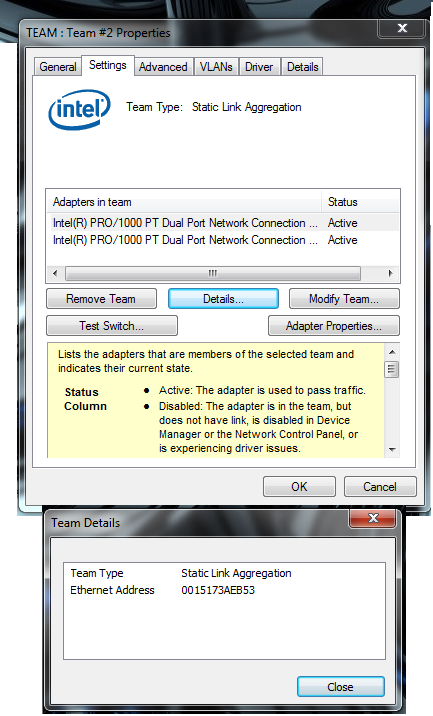

I realized this is an old thread but in response to the last statement:
http://www.intel.com/support/network/sb/cs-009747.htm
The Windows driver I'm using has an option for static aggregation and another for dynamic link aggregation.
