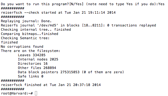

Have you run Reiserfsck on that drive?

I should have tried reiserfsck before, but i didnt. I am currently performing a parity check and will run reiser afterwards.

Reiserfsck did not return any errors

So it is probably not a plugin problem, and reiserfsck says that its not a directory problem...... and I cannot delete the sparsebundle (to delete the share) from either the console, telnet, or Finder. Nor can I cd into the sparsebundle to delete individual directories (as to break up the work that rm has to do) So I am at a lost at what to do.

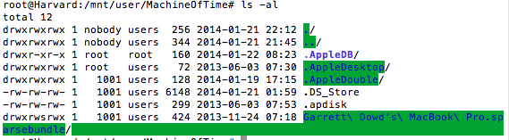

I attached a screenshot of the permission for the files on my TimeMachine share. (This is the only other thing that I can think of that might be a problem)
